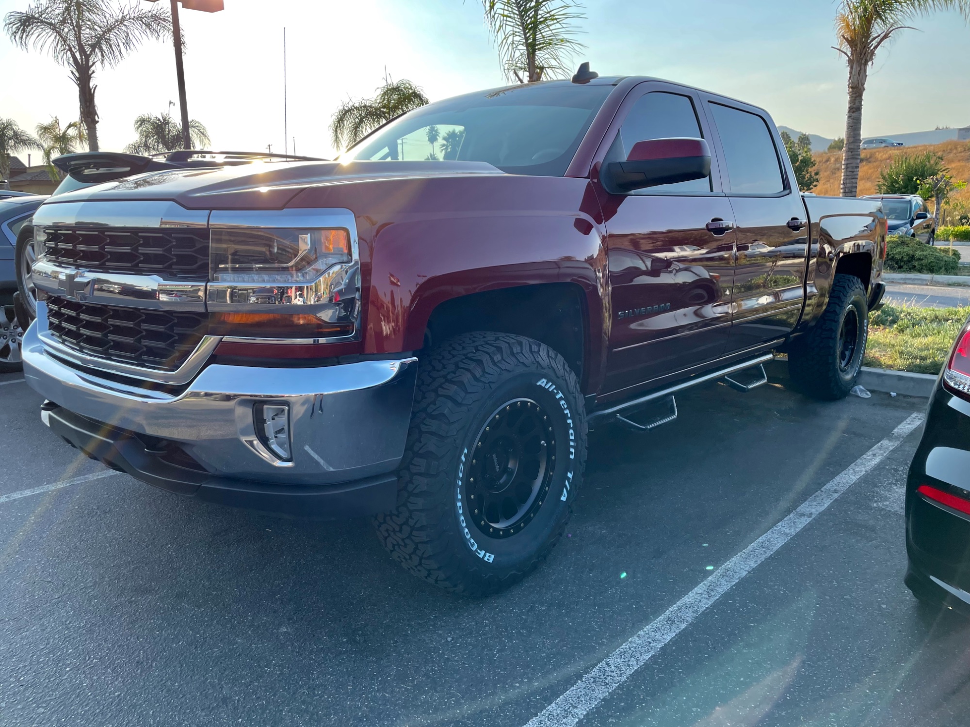

Leveling kit in the front, 17" Icon Rebound wheels zero offset in titanium wrapped in 285 75 r17 BFG Ko2 tires. Very minimal rub near full lock on fender liner.

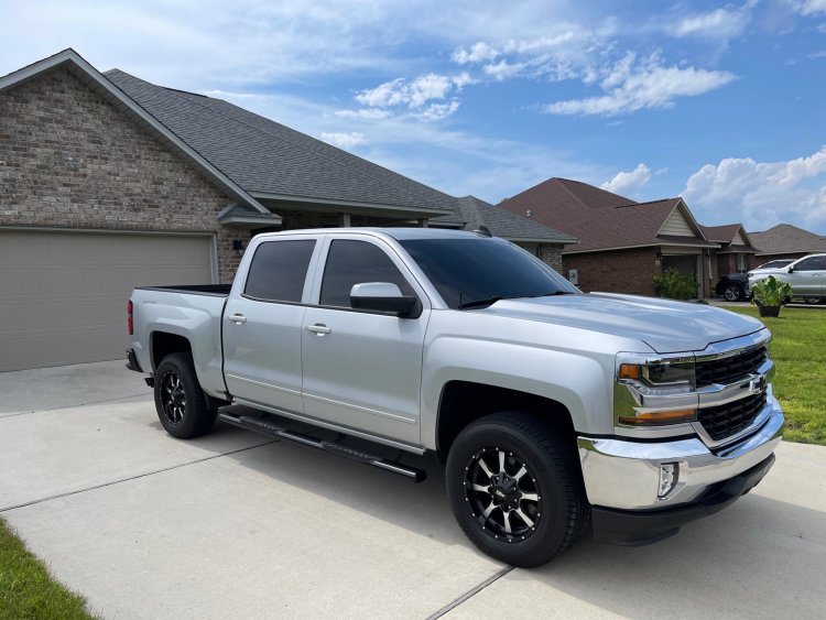

7in Rough Country with loaded struts. 35 12.50 20 Nitto Trail Grapplers on 20x9 (0 offset) Moto Metal 970s in Black/Gunmetal. 1.5in rear spacers.  No trimming but plastic air damn was removed.  Slight rub in reverse at full clock.80394F1A-08D2-4F91-AC89-E2EA7E6D62BB.thumb.jpeg.4adb9bb4193bb3eff6062baa6b418280.jpeg
