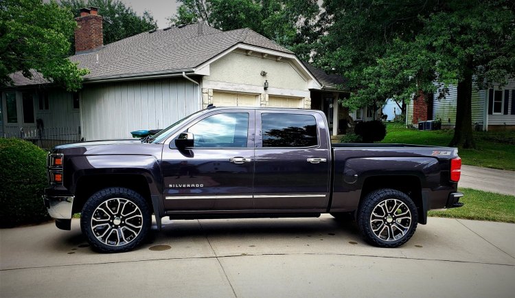

17 hours ago, Z-7-1 said:
@IronVilkas I'm running 275/65/20 right now and love the extra height, but the Nitto G2s are almost done after 70k miles and I want to go with something wider while keeping the height. The setup you did looks great and is probably the biggest tire you can fit with a level.
I need to change wheels anyway, these came with the truck and they keep the tire tucked pretty far with the +35.d124cdd4effedcde865209c6575c75b7.jpge0d7d0a709f769317529c38238689c29.jpg

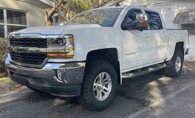

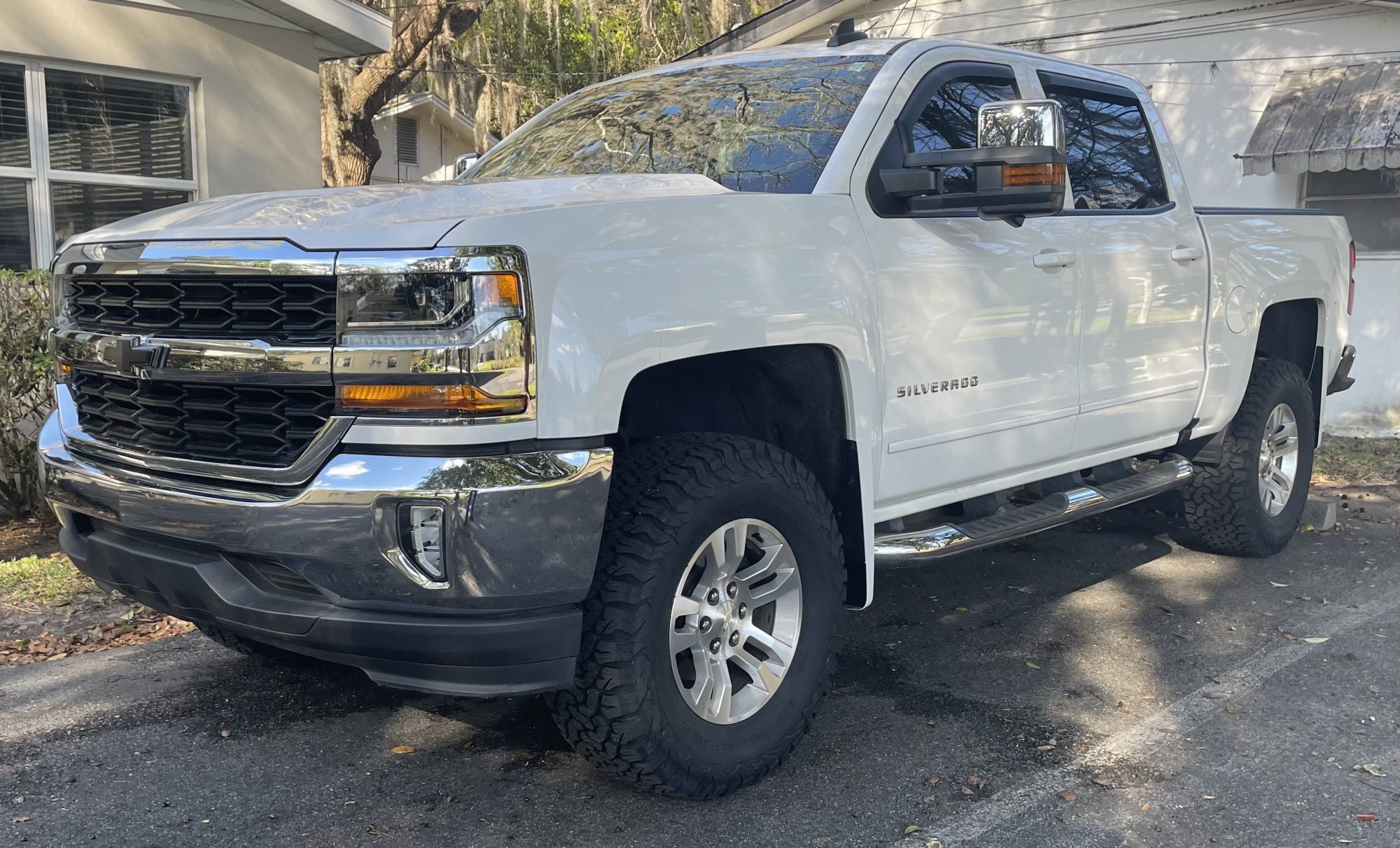

RC 2.5in level, Stock 20s, and 33X12.50R20 Nitto Trail Grapplers. Minor rubbing on sway bar at full lock. No trimming. F87A28A6-7DF0-4ECA-BBB8-08FEAEE87C2D_1_201_a.thumb.jpeg.46b16e1ca303eae46871b3df7fa6487e.jpeg34D66594-515B-4099-A717-E1D76CE486C9_1_201_a.thumb.jpeg.59ba9076d350a9a3642eaab4b0065e97.jpeg

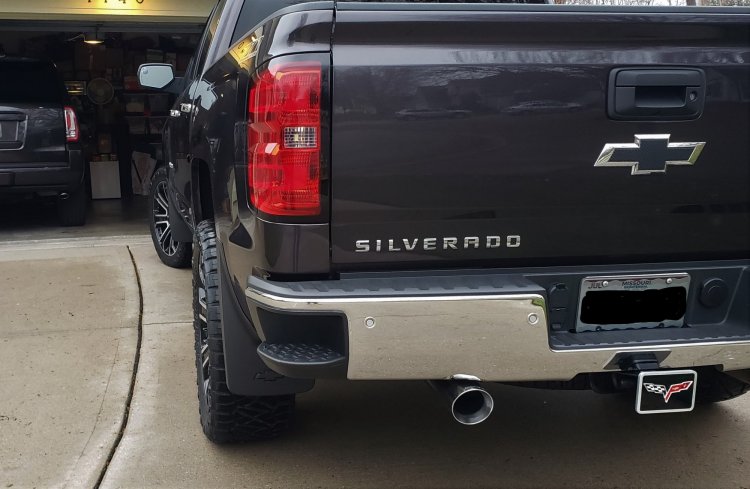

20201212_152501.thumb.jpg.f05d3f2835f2df82a142645937320a88.jpgEven though my 305's weren't rubbing I decided to push them out 1.5" with some BORA wheel spacers.  It looks so much better and still no rubbing with 2.25" ReadyLift Level. No cutting of studs because my Factory Repo wheels have deep pockets on the backside between the lug holes.
