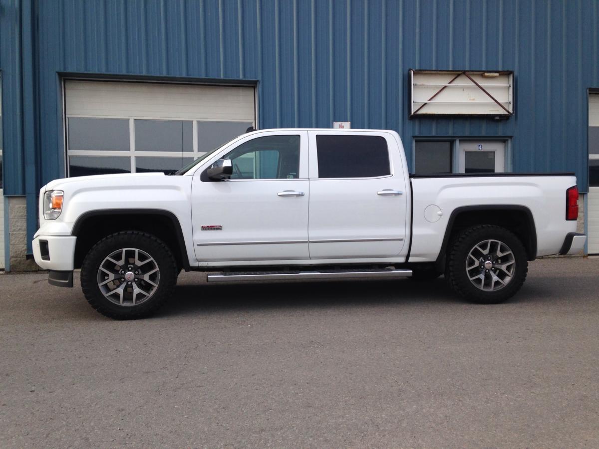

pics of 305 or 295s on allterrain with 20s
hi looking for new tires for my black allterrain with the factory 20s ,going with a 2.5in level ,wanted pics of 305s or 295 s can u postpics of what u have ,and any comments on rubbing or trimming ,dont really want a rubbing issue thanks guys

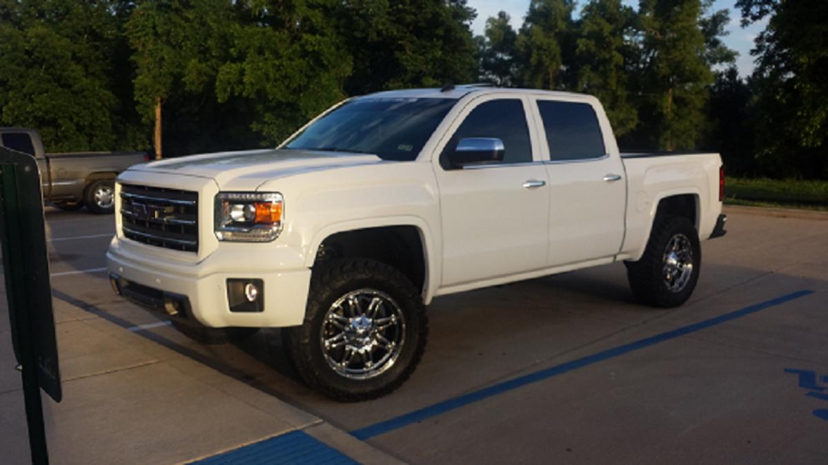

I don't have any good pics yet but this is mine with 295/60R20 Nitto Trail Grapplers. The second pic has my fender trim pieces taken off because I was getting them painted. Pics do not do it justice at all. Everyone that has seen it in pics then in person has freaked out over how much better looking it is in person. I will try to get better pics when I get back in town.
I went with Goodyear Durac 305/60/R20 on my stock rims, I have the ProCom 2.25 leveling kit. The ground isn't level, when I measure it I have 3/4 of a inch higher in the rear with an empty box.. Think I need a cleaner photo
I have only rubbed once, it was on the inner liner towards the rear of the fender. If i have to cut it there is no metal behind it

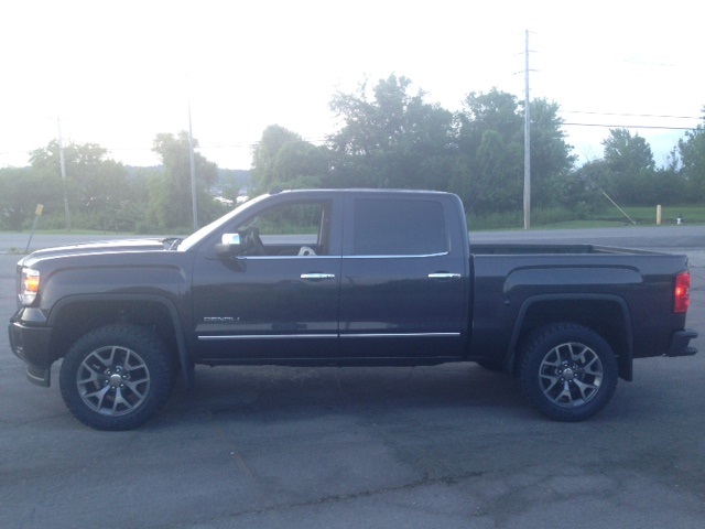

Here are some I just posted the other day, I have a 2 1/2 full rough country kit. I have 295/55/20 Toyo AT2 xtreme tires kon the all terrain rims for the denali and it rubs by like a 1/4 inch on the sway bar at full lock. The 305's will fit but they will rub going by my account without question.
