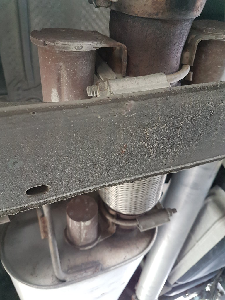

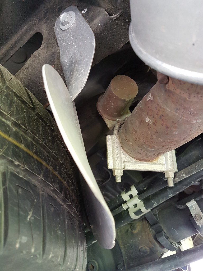

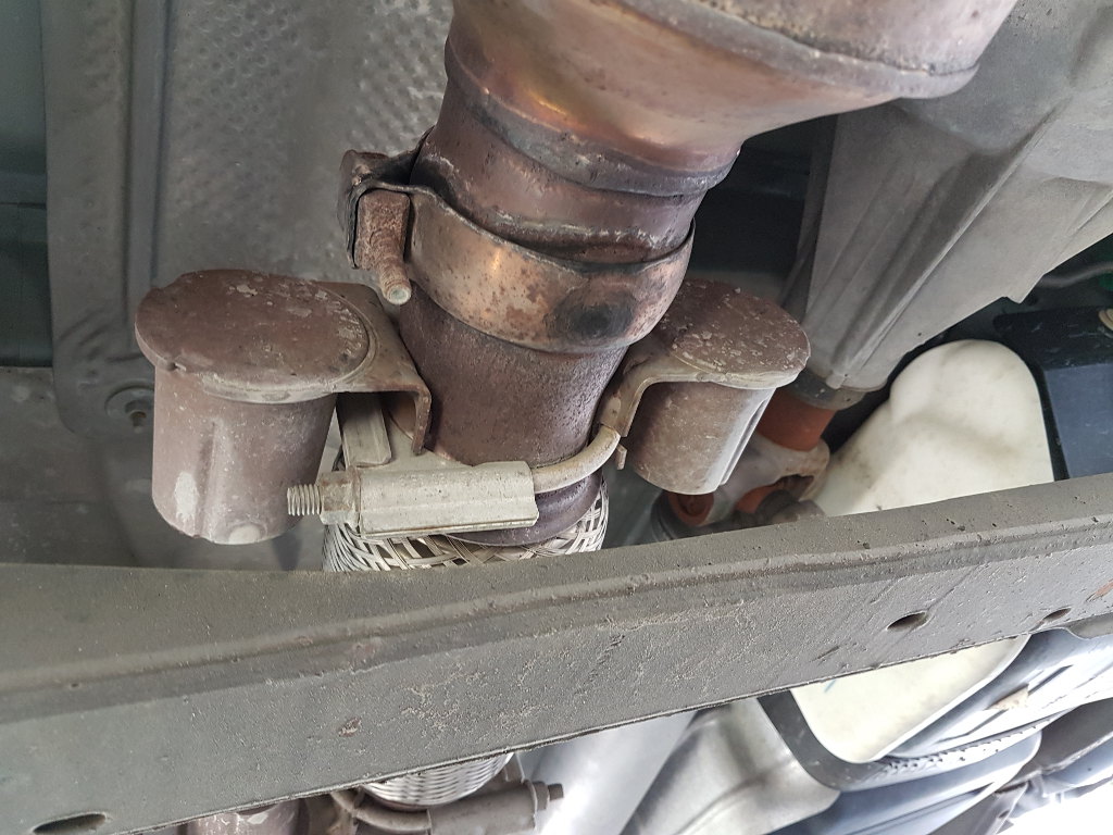

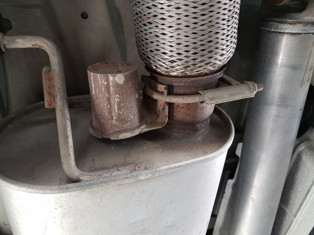

Very interested in hearing more about these 6 exhaust dampeners. Any more info and or pictures? Where was the dealer that did this?
I finally got around to taking some pics. They're not the best as I only parked the passenger side on a curb so that I could crawl under more easily. I was only able to find 5 dampers. One next to the spare tire and 4 just behind the catalytic converter.
These exhaust dampers eliminated the "booming" sound that could be heard on gravel/snow covered roads and when driving over other bumps. It sounded like a 12" subwoofer was being flicked.
My Yukon is still noise free. I've heard the buffetting *maybe* once or twice since the tires were RFB'd and it might just be in my head or it's mild and brief. I'll be replacing the Continentals with MICHELIN DEFENDER LTX M/S at my first opportunity but that might be a while as I have my BFG KO2s for winter duty. The vibrating was 100% eliminated with the new rear axle.
Hope this helps!
Hope this helps!
