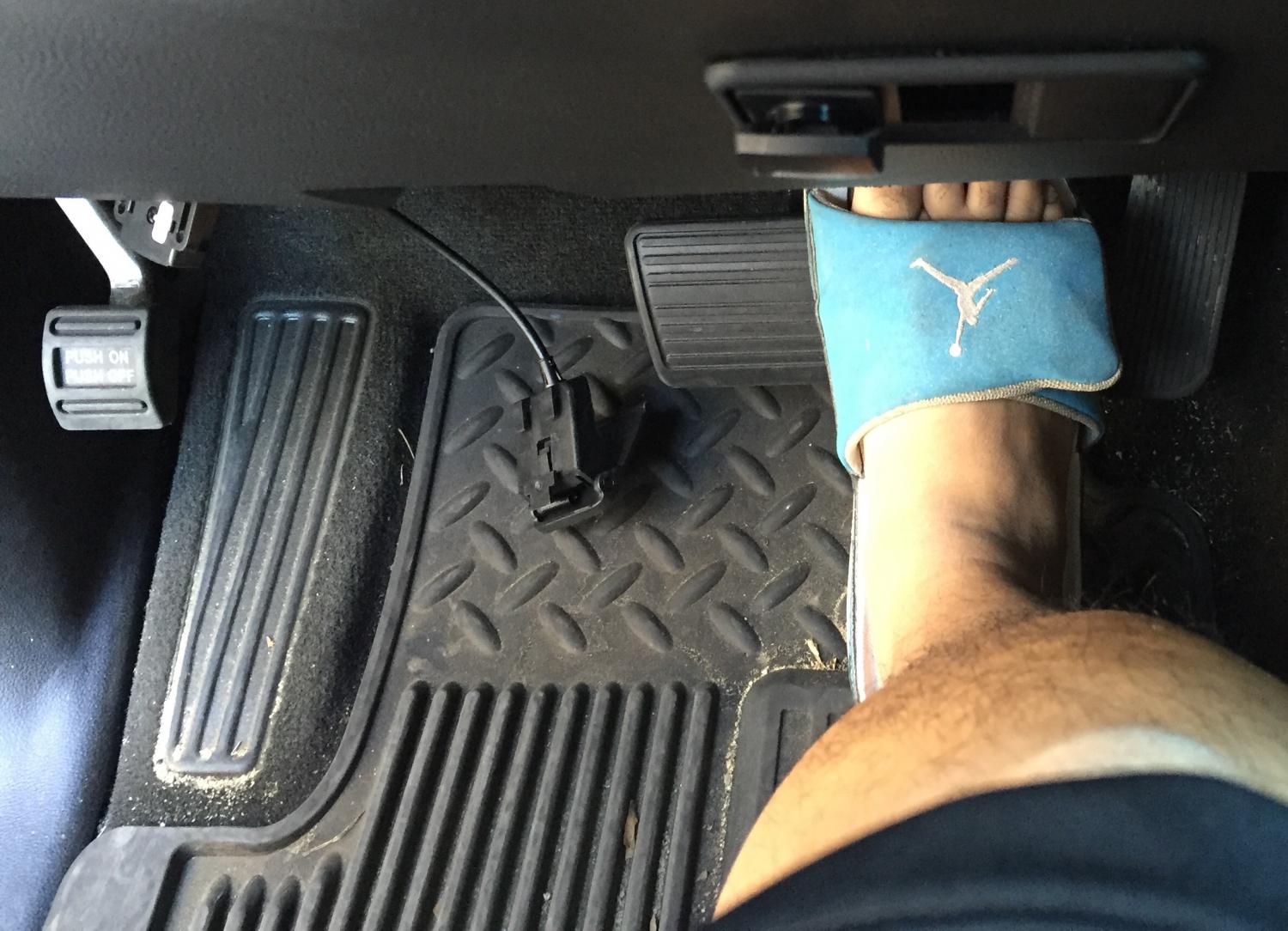

And this little switch is how I turn it on and off with the fob no need to cut any holes in my truck.
