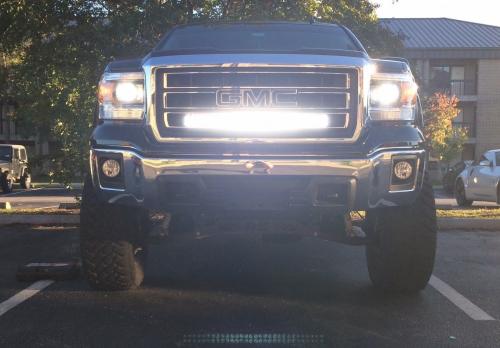

Lights behind grill
  • Replies 406
That looks cool
Thanks man, it's still working great.
A lot of others have purchased my mounts now, always seems to line up very nicely with a 30" bar.
No problem brother
Used a length of bar stock to hold the light bar behind the grill. If anyone is interested, I can post/explain the build I did.

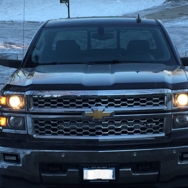

Hello-
I just purchased a 2015 Silverado LTZ......love it. I am installing a 30 inch dual row light bar behind the grill this weekend and I have a question that I need help on if anyone is able...
I want to tap into the high beam wire so that the Light Bar works with the high beams and the switch, which goes through a relay. What color is the high beam wire I need to tap into?

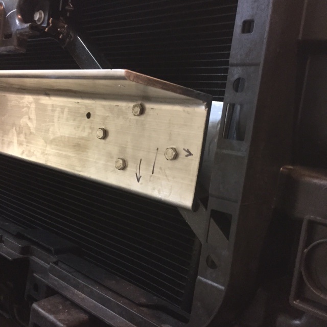

I installed a 30 inch light bar behind the grill this weekend.
I will attach some pictures of the mount I made. I basically sandwiched the radiator square stock support bar between two pieces of 3/16 inch aluminum.
