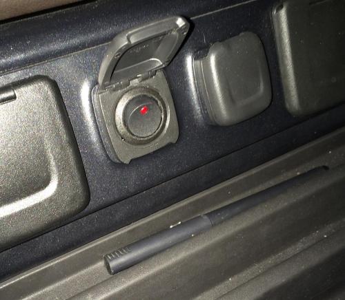

I plan on mounting the switch in place of one of the cigerette 12v socket. I seen this done by another member and I like this switch because you can still close the cover. Looks really clean and factory.

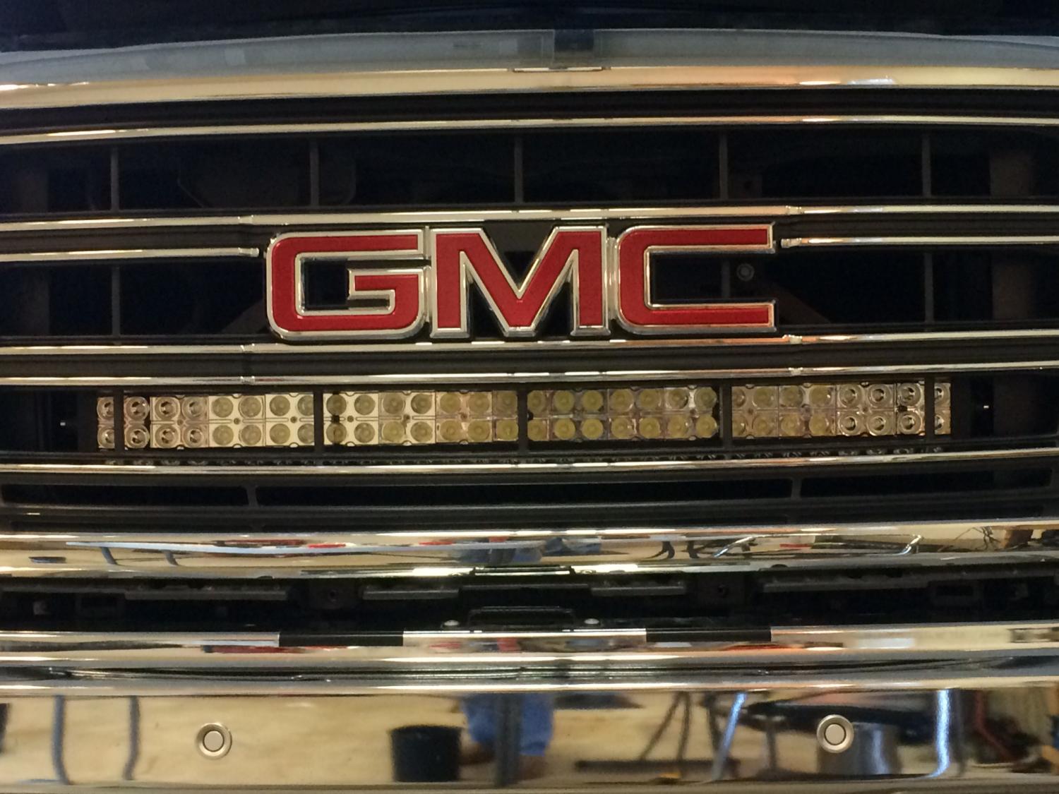

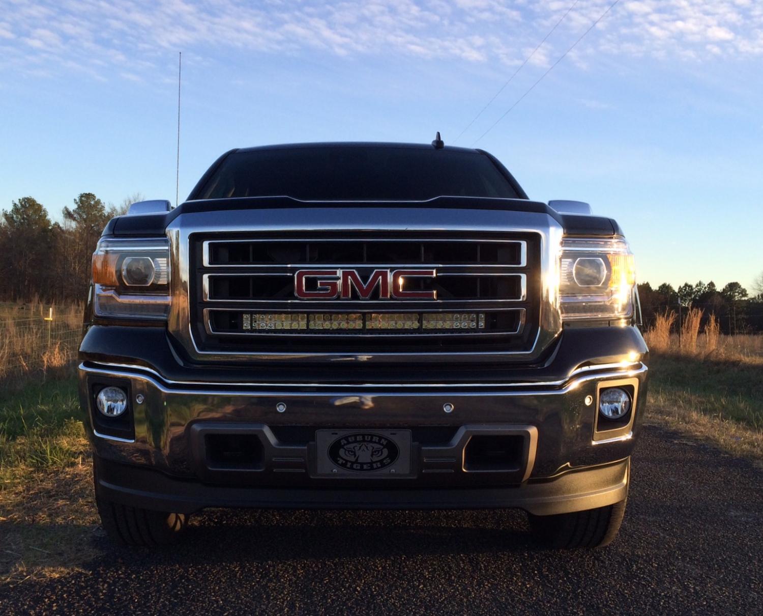

Ok. I got everything installed and it turned out GREAT. It is exactly what I was going for. I was a little worried about the double row not centering as well as I wanted and the 32" still requiring a little trimming on the plastic which I did not want to do. I do not like to cut or trim anything. Here are just a few of the little things I was worried about or problems I ran into and fixed. First of all I ordered a OPT7 32" dual light bar with switch kit. I really wanted the kit because I wanted to use one of the accessory power outlets instead of drilling and cutting for a rocker switch. I like rocker switches on RZRs and ATVs but like to keep a Custom/factor look on a new truck. i should have went winless but for some stupid reason I wanted a switch but did not want it to look like I added it. Second, I wanted a 36" but thanks to the tried and true post of other members I figured out anything past a 32" required trimming the plastic. I used a piece of 2" (I think) flat bar and mounted it on the angle brackets in front of the radiators. I left a little over 1" past each side so the light bar mounting brackets could bolt right on. It worked great and was very clean install. I painted the flat bar with plastic dip and painted with semi gloss black. I did not have to cut or trim anything. there is VERY little room left on each side which is what I wanted. It filled the space perfectly. There is hardly enough room to get a Allan wrench in to adjust the light bar without taking off the grill again but it can be done. I could not find where to get the power inside the fire wall (this is the only part I did not like. It isn't a big deal but I'm a perfectionist when it comes to keeping things right even if you can't see it) so I hid the wire from the battery to under the truck. I drilled a very small hole in the rubber/hard plastic drain hole cover under the front passenger seat for the wire and used a grommet to seal it. It looks professional but I would have preferred the fire wall if I did not have to drill it. The last thing is getting the accessory power outlet out (cigerette lighter) For some reason mine was a HUGE PAIN IN THE BUTT. From other post I have read this was not a problem at all. IMO and after researching and looking at many options I think this is the best option out there and I would do it again this way. I wish the pictures would do it more justice.
The alignment is perfect. The angle of the picture may make it appear off just a little
I will try and resize the picture but putting the switch where the 12v accessory plug was turned out really good.
Any pictures of how you mounted it? and made it line up properly?
I like it
Yup - very clean.
