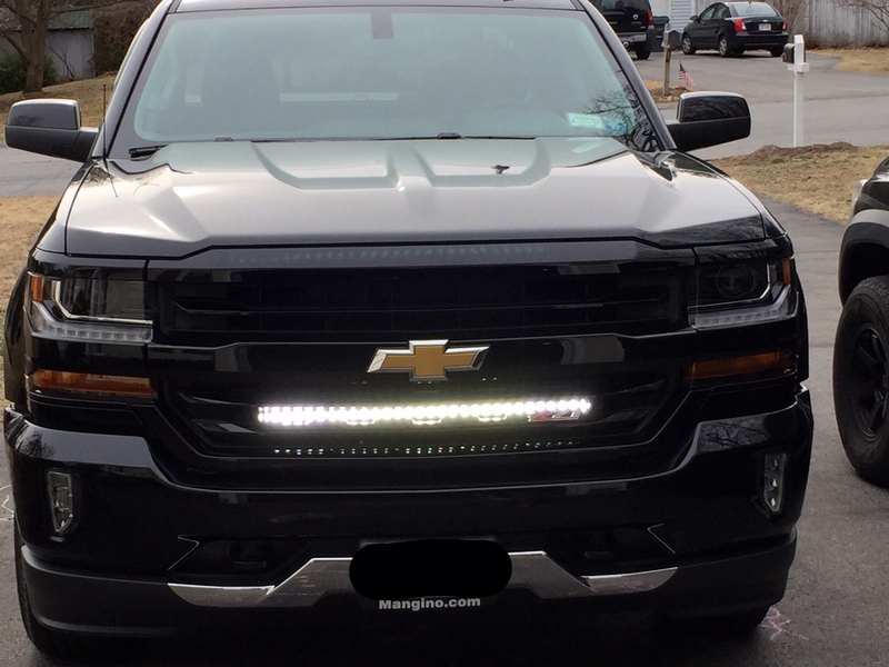

Has anyone actually cut out the honeycomb chrome grill to have the lightbar not be recessed behind it where you lose a lot of the light? I'm toying with this idea.
Just did mine
A dremel was my best friend for this project, i had to remove the air dam that bolts to the rear of the grill, i had to the honeycomb from the inside to clearance for the lightbar, also had to cut the plastic shroud that bolts to the front of the radiator so the lightbar can sit flush with the grill

Looks awesome!
I wired my light bar to my fog light switch and wired my fog lights to to my low beans. Didnt have to go through The firewall. This week I'll do that mod that let's You put your high Beam and fogs on At The same time. My bar is recessed behind The grill. Probably 95% of The light passes though..

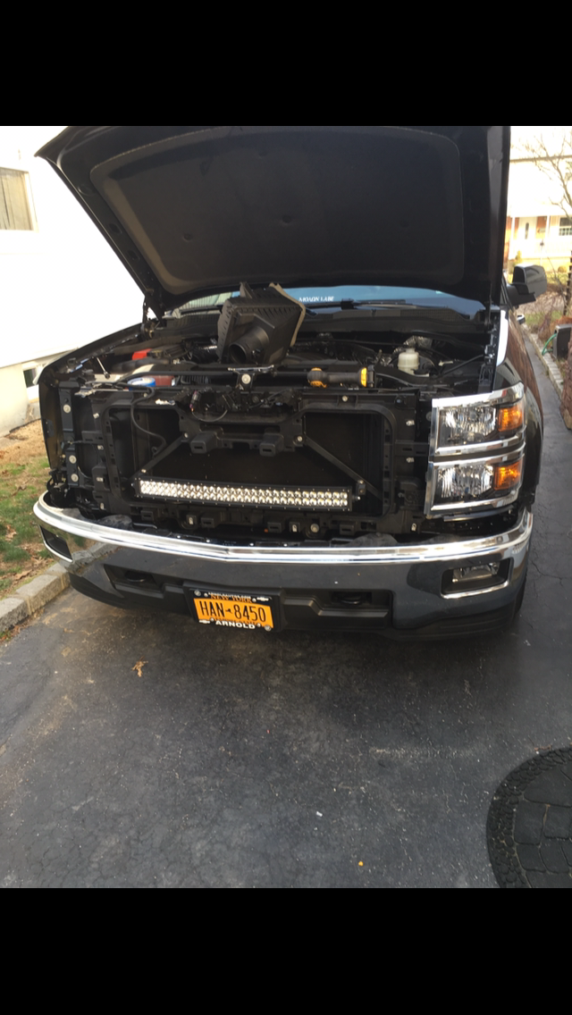

All the wire is run and the switch installed. Just need to remove the grill and install the light

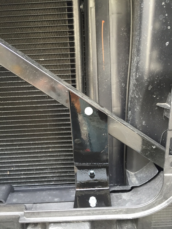

This is how I mounted mine behind the grill. Made the brackets out of aluminum.
Mother nature won today so no progress. Considering a change in the grill to a white one now with black mesh and white headlight surrounds. Or possibly the chrome grill with black honeycomb to break up all the chrome.
Sorry. Pics on mounts made for behind the grill. Made from aluminum
Looks nice... pics at night please with the lights and fogs on as well
