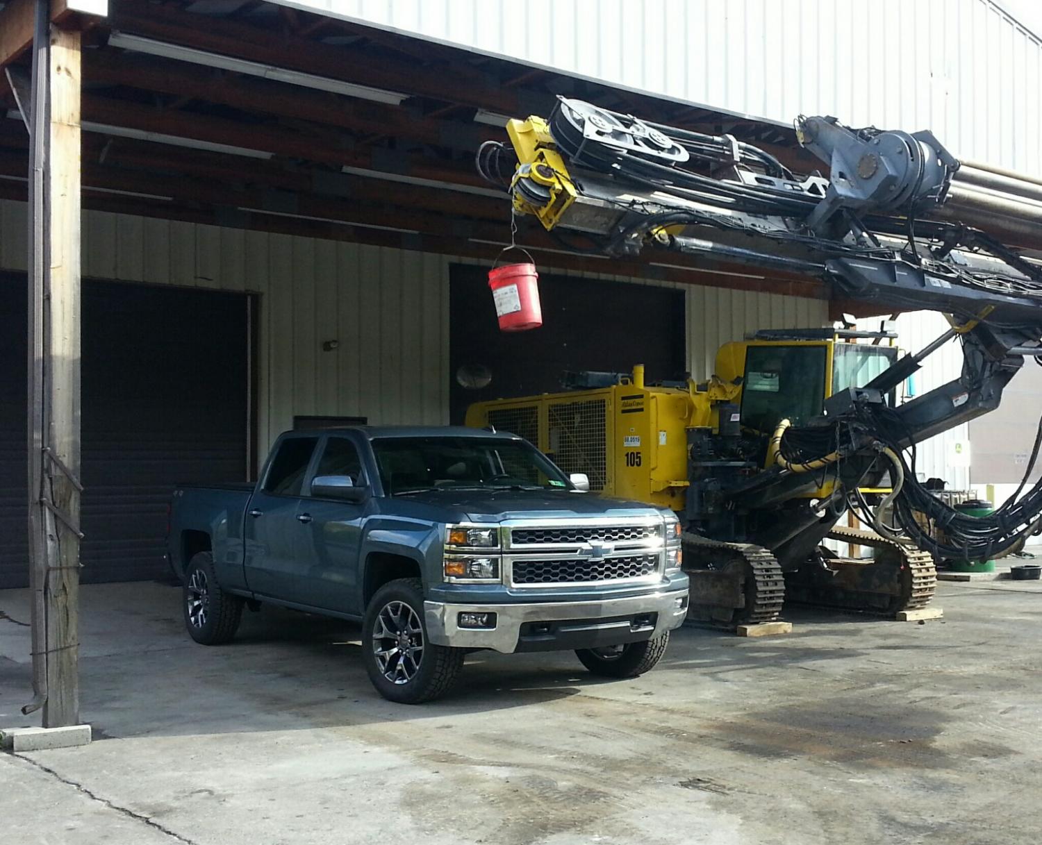

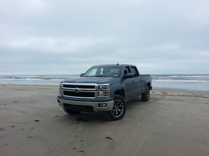

you have pictures of this setup from a front or back angle?
Sorry I took so long to reply.. these pics are the best I have right now as I just got back from OBX.. hope these help
Cleared these tires with ease airing them down to 20lbs and going over the dunes, everyday driving, on the hunting trails, etc. Can a bigger tire be stuffed in there, yes, but as they say .. "been there, done that"
