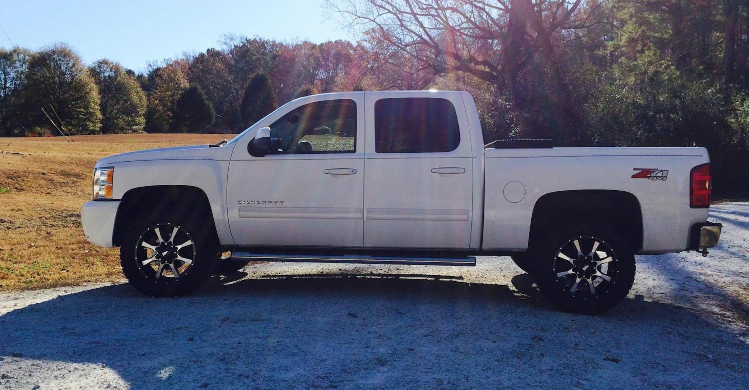

I decided to go with the new BFG A/T KO2 in 275/60r20 and love them. Wheels are Moto Metal with a +18 offset. Leveled with a Rough Country 2.5 leveling kit. No scrubbing at all.

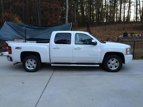

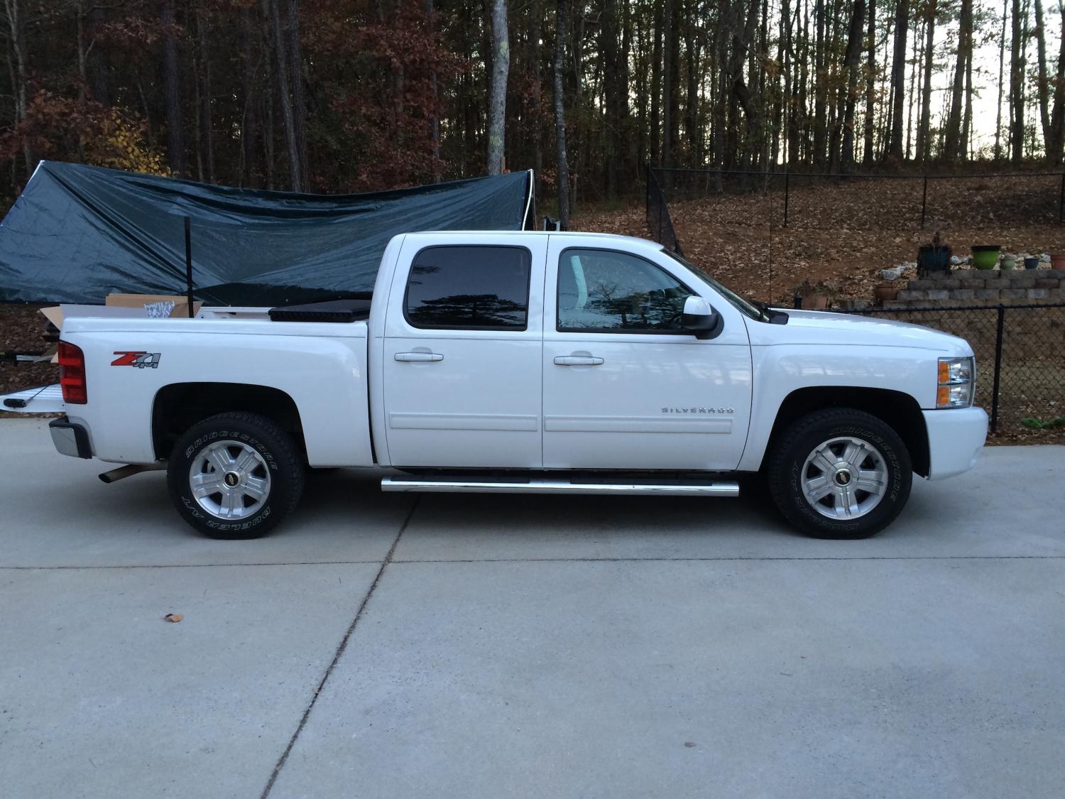

I just got the Toyo Open Country AT2's in this size about 2 weeks ago. I had the cooper atp's on before in the same size and took them off after 5k miles because 2 of them had pretty bad lateral runout and cause a vibration at highway speeds. Looks department the Coopers win out, ride quality the Toyos have the edge. The Toyos ride great but I might consider something a little more aggressive and these seem a tad on the skinny side since the tread curves in instead of being the same width as the section width. I am on the fence right now on going with practicality vs. looks, since I don't really need to add the extra weight of a 10 ply. They are a great middle ground though and would highly recommend them if someone wants a middle range all terrain tire. Here are some pics up close since there aren't a whole lot floating around on the Internet of the 275-60-20 Toyos.
Picture of the cooper atp for comparison

Bringing this thread back, I started a thread about 18" wheels and tires but figured if am going to do it might as well get exactly what I want and I would like the identical setup to this. Only problem is I have the 2" RC leveling kit. The wheels will be Moto Metal 970 +18 offset 20x9 and tires 275/60r20. Will this rub or will I be okay with a setup like this?
