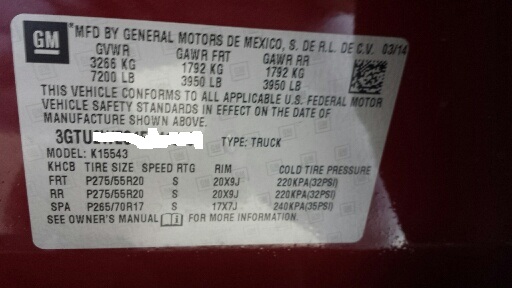

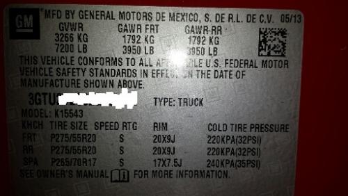

What a bunch of jerks. Ill-informed jerks at that! It doesn't matter because he can't tow more than 6500 without going over his GVWR anyway? Somebody needs to buy these guys a calculator.
That is why I canceled my account and un-joined the site. I did take a pics of the stickers they were wanting (from both trucks), but after they were so rude I never posted them. But here they are is for anyone on here. Nothing on them were different.
