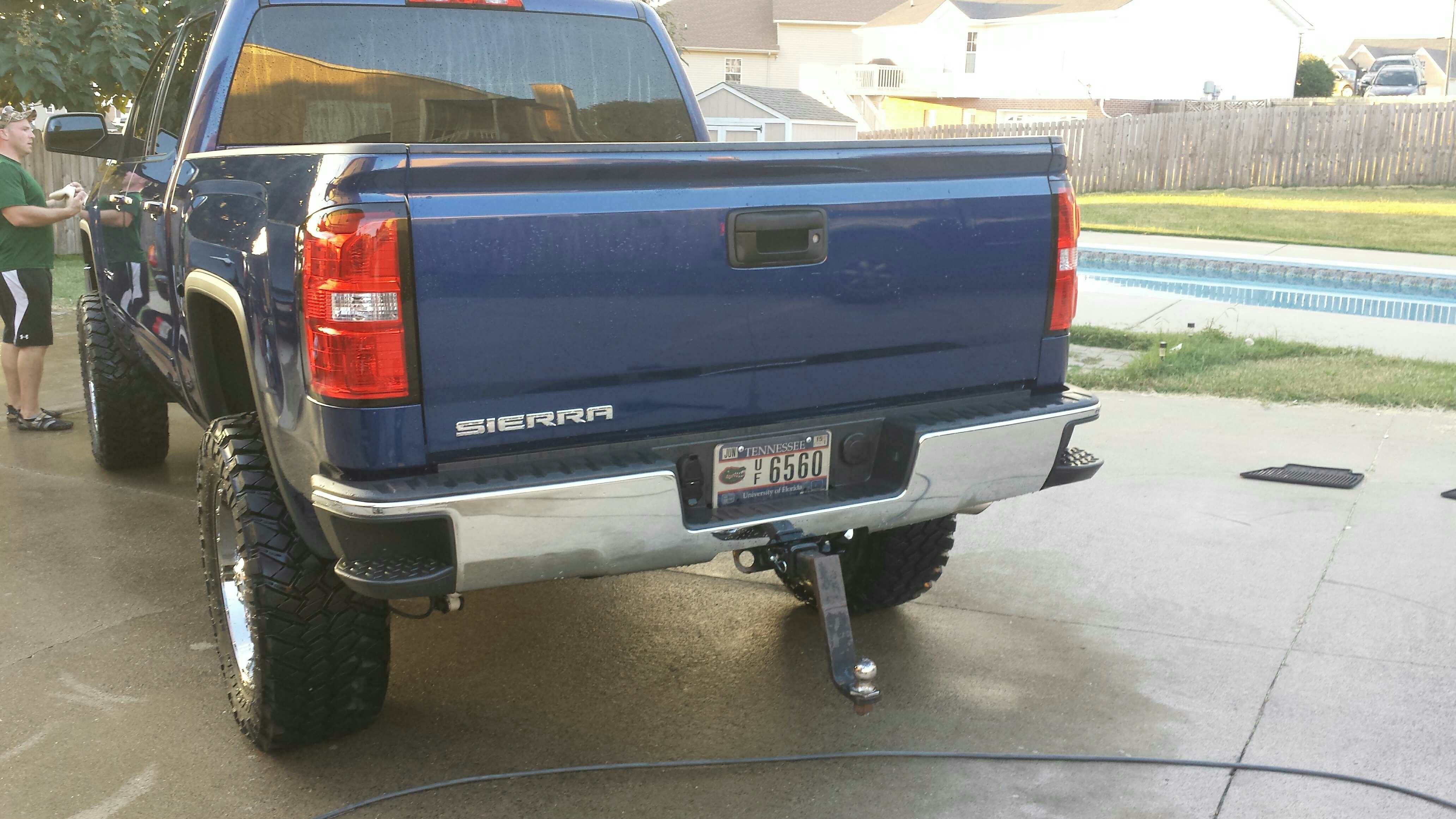

The Quick and safe way would be to use fishing line, followed by the 3m wheel that removes residue. The wheel is safe on paint and takes the residue right off. Finish up with some auto detailer. post-134365-141184644737_thumb.jpg
It sounds like your Sierra is brand new. My way, is to get it good and hot with a hair dryer and pull the badge off by hand. Usually I get a corner started with a small flat screwdriver. Use both hands and make sure the screwdriver doesn't touch the paint. Once you can get your fingertips in there, carefully pull the badge off. Usually the badge will be undamaged and a majority of the adhesive backing comes with it. What little adhesive that's left comes off easily with your fingertips (not fingernails especially on dark colored paints) and some automotive sticker remover or WD-40. I have found this method to be the easiest way to remove the badge and most of the adhesive backing in one piece. Follow up with a shot of spray wax. Of course older trucks with baked on badges will require more work.
Makes the truck look clean not all gauty with crap stuck all over it. Plus the don't pay me too advertise.
Debadging looks clean, makes waxing easier, and just plain looks better. I have debadged several GM trucks and I've yet to find one that was easily done with my finger tips. By the time you do the entire truck your finger tips will be fragged. 3m eraser wheels is the way to go.
