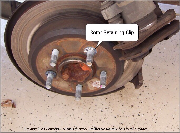

Each brake drum has a small metal clip that needs to be removed before installing aftermarket wheels. It's a common mistake that really throws off balance.

I would put my money that the brake clips are still on or they either did not put on your hub rings or did not realize that they needed them and did not sell them to you. However it could very well be they just don't know how to balance which is not uncommon.
I just ask the shop who install the tires and wheels about the stud clips and hub rings. They said the clips were removed and hub rings was installed on all four wheels. With another failed attemp at balancing my wheels, they said I provided bad tires. Well I guess next step is to check with my tire shop and see what they say. I hope they get it fixed cuz the tire/combo is balling. Again, I apperciate all of your inputs.

the clips are no problem if you have recesses in the back of the wheel around the lug hole.
