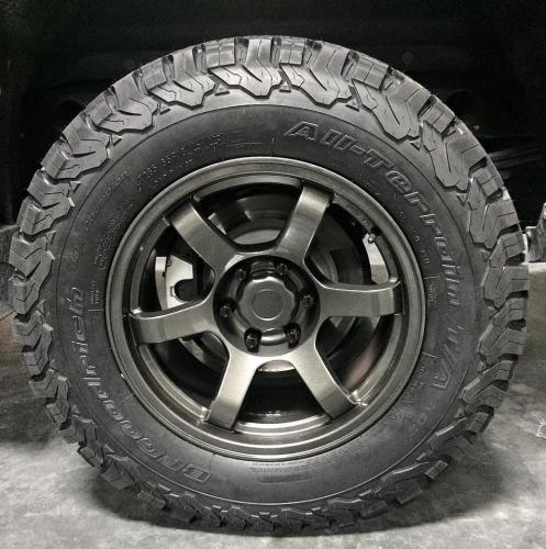

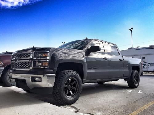

Lift- 2.5" Rough Country level with rear blocks.
Tires-BFG KO2 285/65r18
Wheels- FN Wheels BFD 18x9 0 offset
Fit-flush with fenders. NO rubbing, NO trimming.
