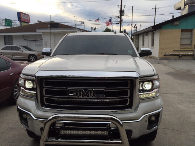

Just thought I'd share this for some opinions, I just found a pretty nice photoshop app (just one more thing I needed along with this forum to help my mod list grow right? Haha). Well I was able to make my headlights cleared with photoshop, what do you think?
That's freakin sick. I want to do that! That's way beyond my skill. I would need to have a test set first.
