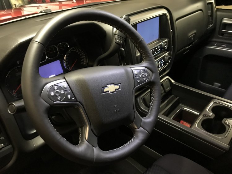

just finished heated steering wheel swap on my 14 silverado LT, the wiring was not present on my column harness. i was able to source the plug and pin the connector and tap into the ground for the column harness, i wanted it as close to factory as possible.t total cost for was around 210.00
New heated steering wheel-   150.00 through ebay
New clock Spring - 60.00 through my  local GM dealer
Plug- free i was able to source from a harness i already had (pure luck)
from the harness connector under the dash i had to run a power to the X51L connector (drivers side fuse box) where the fuse is located for the heated steering wheel 7.5 amp fuse the only one in there i did verify that the heat turns off on ignition and also pulled the fuse during operation to ensure it was on the right circuit. Pgamboa sent me a pre terminated wire to go from the column harness connector to the X51L fuse block. Word of advice make sure the wire front the column connector to the X51L is the same gauge thicker wire caused my heated steering wheel to short cycle
the cost can be further offset by selling your old wheel and clock spring. which is my plan
