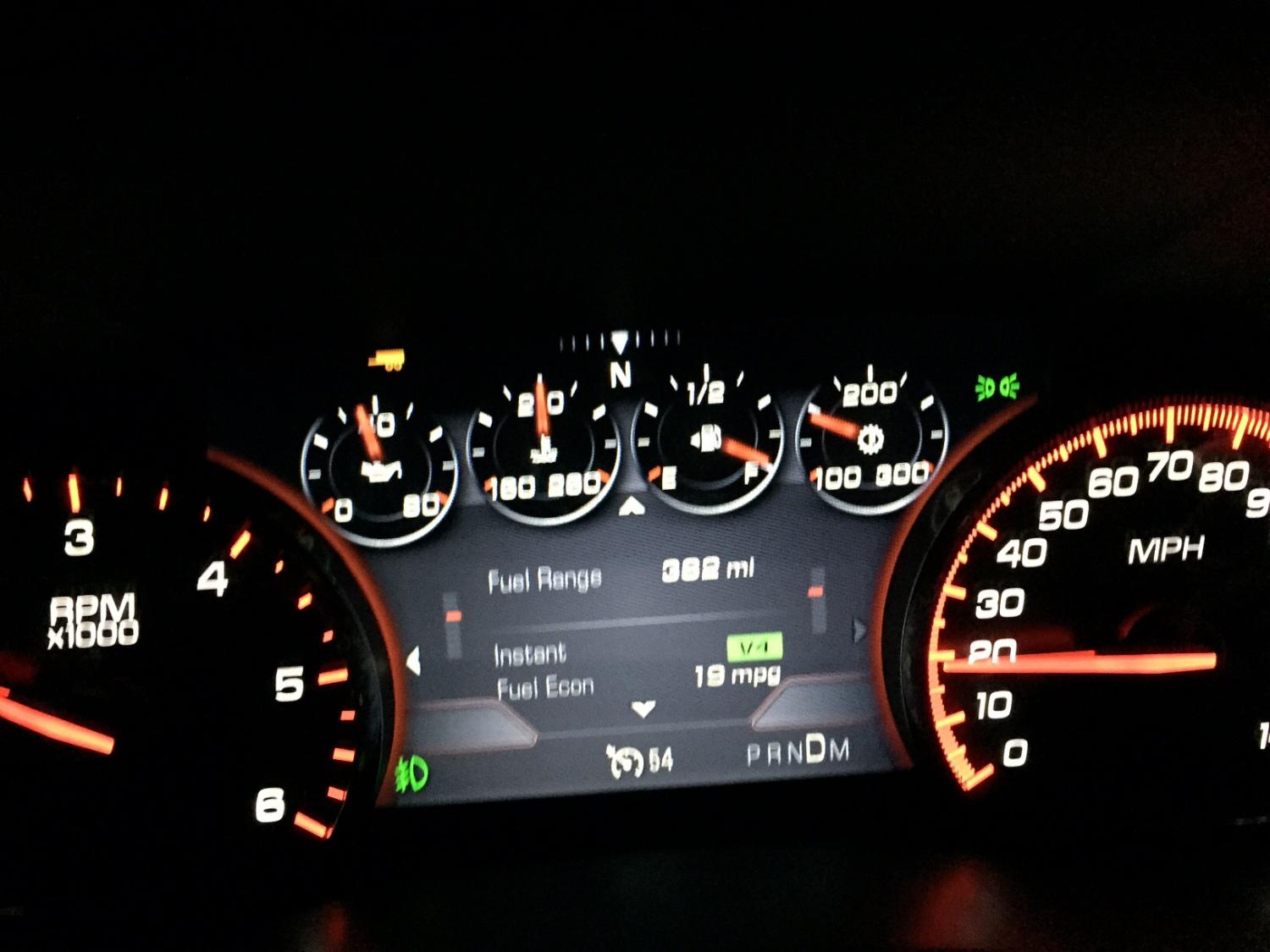

I am not sure if my temperature guage for my transmission is working correctly. I have been tracking the temperature after driving more than 10 miles and I can't get it over 150. I was running 40-60 mph. The outside air temperature right now is in the lower 20s. Is this normal for the temperature to run this low after 10 miles? Can anyone else with 8 speed reply with what you are running.
If you are having this problem I would bring it in and get it on record. Make sure they do any and all updates accordingly and put it on record if there are any further updates you want to be given notice. It sounds like it could be just a software issue which GM is still working on it because it is a new transmission. Maybe this is the reason why GM is slowly introducing this transmission (test market) to avoid too many complaints until they are able to work out all the issues.
Completely normal, you will need to block the cooling system (grill) to bring the temps up.
