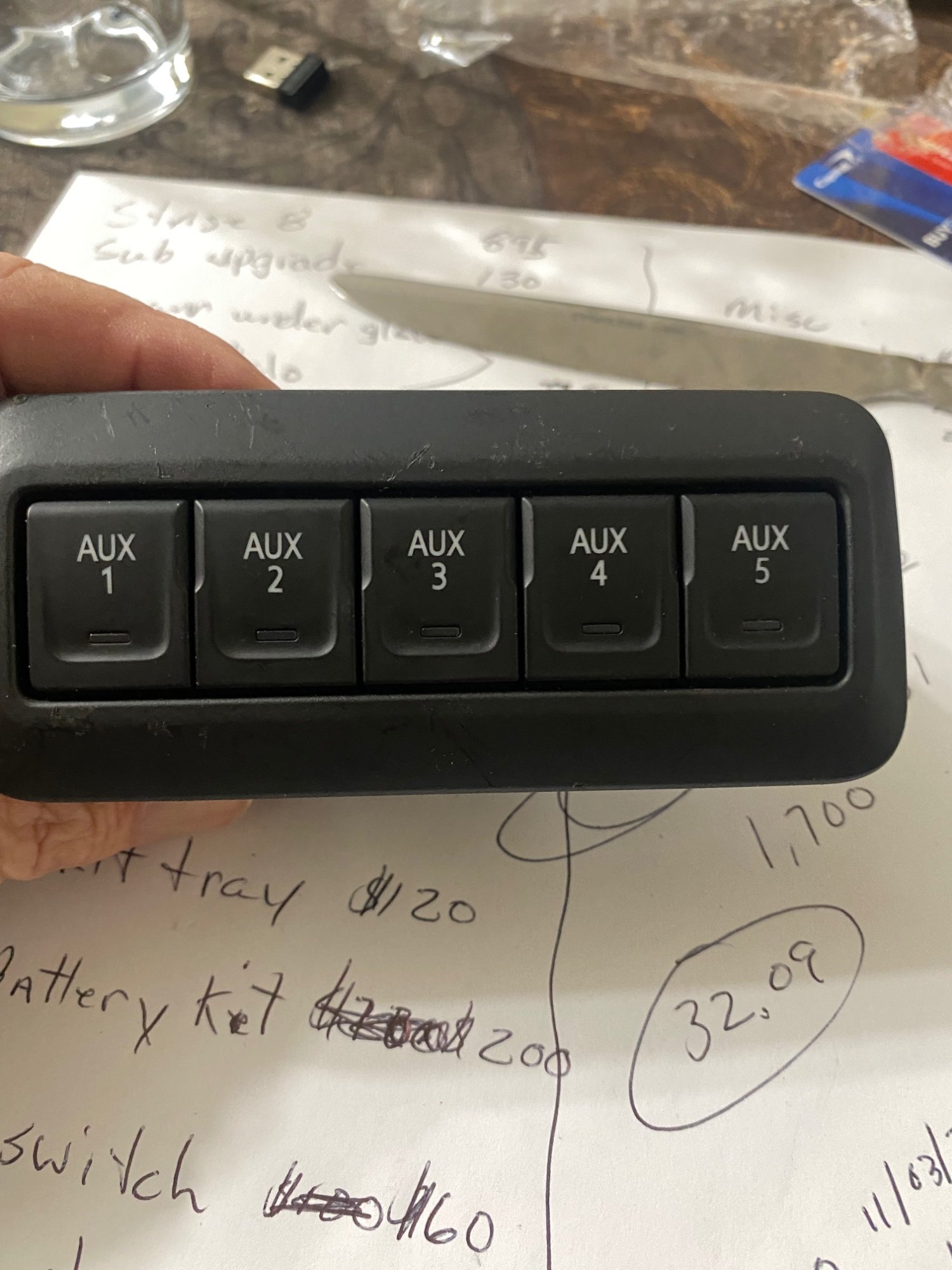

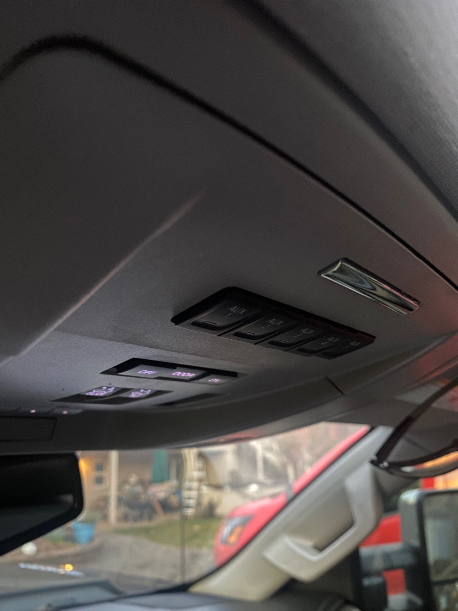

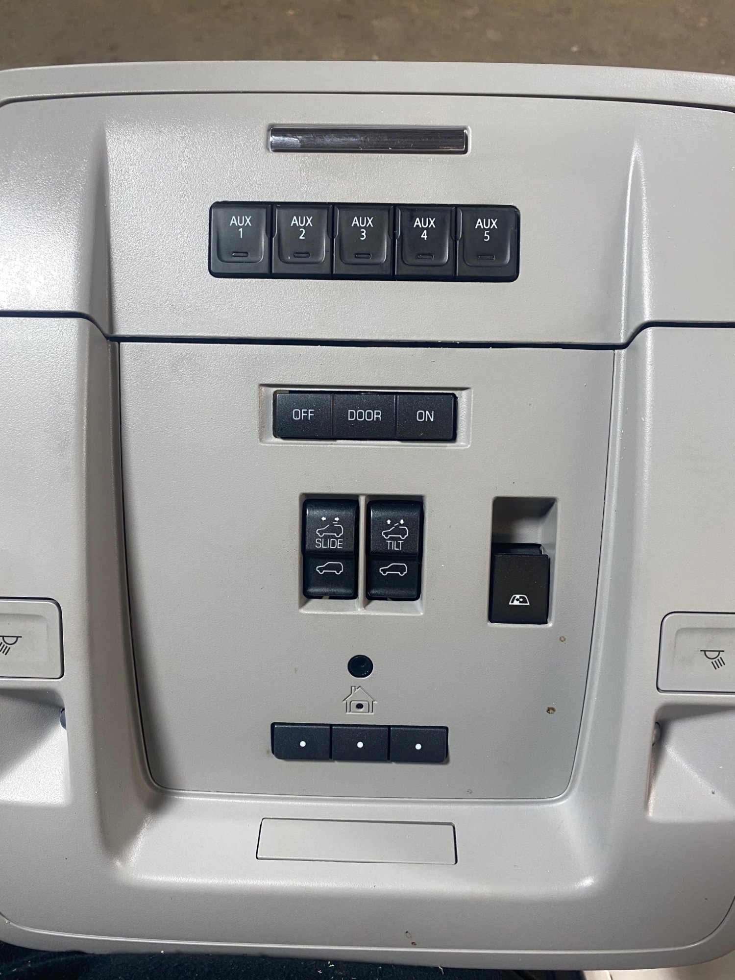

Would like to share some pictures of where I ended up putting my aux switches at. I have one before picture. The rest is after. I didn’t like the idea of the switches being low on the knee panel.
so I will be rewiring and hardwiring the full kit in. Cause this kit is really made for 2019 and up. My truck is a 2017 2500hd Denali diesel. So all my factory uplifted switches are spoken for all factory features.

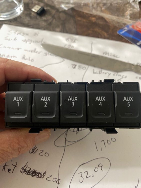

I Just completed a breakdown of the switch bank. I have a 2016 1500 Z71 with the three switch panel, TCS, Bed Light, Hill Descent Control. I bought two additional switch banks and opened them to create one that would work for me. Now I have one working bank with TCS, Bed, Light, Hill Descent control, and 4 aux switches.
Was it hard to do?
On 12/30/2022 at 1:56 PM, Rock1500 said:
Was it hard to do?
@rock1500 It took a bit of work to get them disassembled and put back together. If anyone is interested they can shoot me a PM and I would be happy to look into what it would cost to do. I wasn't sure if there would be a market for it. There is some soldering and de-soldering of some micro components to make it work like it should.
