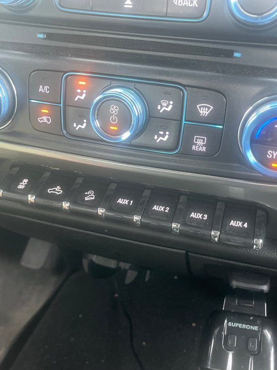

I am impressed with some of your projects and your expertise.  I am not so comfortable figuring out how wires should be installed and really appreciate step-by-step instructions at the level of a 6th grader.  I recently upgraded my 2019 Silverado 1500  LD mirrors to towing mirrors with turn signals.  Got it done because of the help of Mr. Gamboa's harness and instructions. Highly recommended.
I would like to add a 30 inch LED light bar to the front of my truck.  I would like to use the GM 23145158 switch bank (stolen picture attached). Currently my stock switch bank has only "traction control" & "cargo lights."  I do not want to re-label the AUX switches, just want to wire a LED relayed wiring harness to AUX 1 to operate the LED bar.
I would appreciate hearing from you if you can get down to my level.
Selo

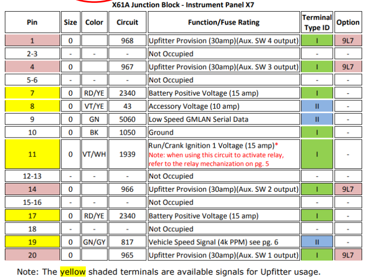

does anyone have the diagrams showing which fuses under hood need to be relocated / installed for this aux switches?
I have a 2016 2500HD WT that came with the switches, I bought the wire harness from GM and plugged it in under the parking brake and ran it out thru the firewall.
seems the GM upfitter website where the pic I need  is down?
thanks
thanks
The relays and fuses should go into the fuse block in the passenger side of the dash.
So the wiring goes from the box to the lights that is the easy part for me. The part that I am having trouble with is from the relay box to the switch.
The switch control the ground side of a relay. You need to have the relay coil hooked to power and the switch will connect it to ground Turing it on.

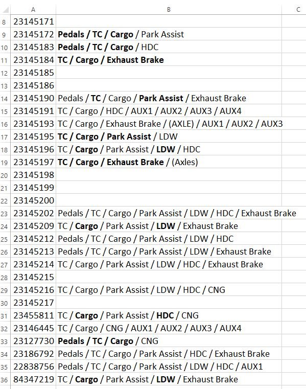

So i know this is a month old or so but people are still gonna come here and take a look at how this stuff installs, as i did 3 months ago. got around to filling in that list of switches and P/Ns on Page 1. Best I could do, still have some missing... but i hope it helps somebody else when the see it. Cheers and thanks to everybody still on this page posting all the good information. for the record, the Bold dictates the large (wide) keys and regular shows keys that are short/skinny.
