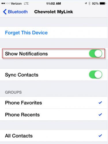

Two things I can think of...
First, on my iPhone 6+, the option to show notifications was not enabled by default. If it's not enabled, you won't get the interaction with your truck. Go Settings > Bluetooth > click the "i" next to Chevrolet MyLink and enable the option. As noted above, Apple doesn't let you speak your reply so you can see/hear the messages but not interact with them. (You can read the message while driving, just listen to them).
