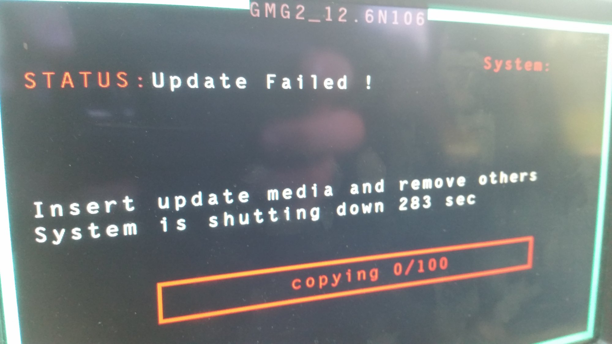

My 14 LT is doing the same. Blank screen. Every 8 minutes or so it shows initialising. Then goes to a screen that says please install update media and remove others. System is shutting down and has a 300 second counter. Screen goes blank again't by 283 seconds. Shows 0/100 installed.
Any idea if an update will fix this?
That is exactly what mine is doing. In addition to that, the radio cuts off every 20-30 minutes and comes right back on. That started later on. I was told it was the HMI module, but wanted to ask here to confirm.
Yep, mine shuts off too. I haven't found anyone else with the exact problemishes til now. So, who's gonna pull the trigger and be the guinea pig?
One dealer said sounds like I need an update. $164 and if that don't fix it I still have to pay it. One dealer said they think I have a bad screen. Bring it in for a $90 diagnostic.
