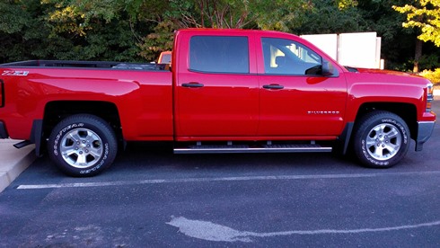

I have seen others complain about the ride height of there new 2014. I have parked mine next to a lot of different stock 2014's and mine seems to ride low.
I have a Crew, Z71, trailering package, and standard bed.
My front fender measurs to 36 1/4" and my rear measurs 37 1/2". I know I will wind up doing a 1.5-2" level for front and a block or add-a-leaf in the rear. I prefer the rake.
My question is what do your fenders measure to on your STOCK 2014? Ground to fender.
My dealer can't explain to me why there is such a difference between trucks sitting right next to each other.

I'm starting the think they used the same suspension and the weight of the longer bed is what sits me down more. This will have to be fixed. The wife likes the steps on the truck. I told her the truck gets a little more height or the steps come off. They get in my way.
