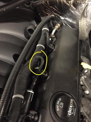

I just want to clarify what goes where. This stuff is new to me. If you look in my pictures below. Do i have them circled right or the other way around.
Since i have the add catch can the inlet and outlets are a little different. So outlet goes to the one under the throttle body and the other one goes to the manifold? Also do i have to disconnect the battery for when i take the throttle body off?
Yes outlet goes to under the throttle body. It wouldn't hurt to disconnect the battery. I personally haven't installed a catch can (plan to soon), but since it is an electronic throttle body I would say yes
