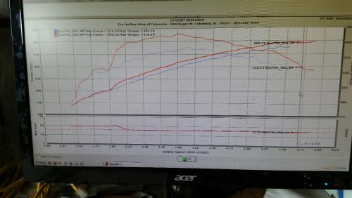

I still want to do it, being as the truck is lifted and has 35" tires on it, it is literally sluggish.
Now I did partially rectify that, I just had a Edelbrock Supercharger installed, I'm having it dyno'd on Tuesday 5/19/15, I'm hoping they can further tune it & get some serious horses & torque.
I'll post the results when I get them.

Here's the RWHP Dyno sheet, 396 HP & 416 TQ! I'll take it, but I still want 3.73 gears!
