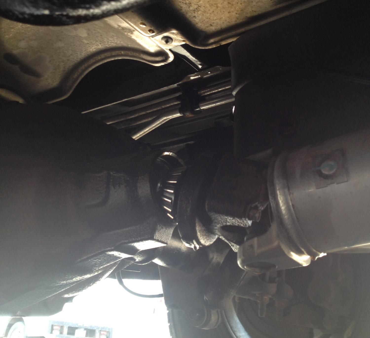

Any evidence of the rear end leaking all the fluid out prior to it failing? Do not really understand how the pinion bearing can be hanging out. Do you mean the area around the cover has not failed, but the pinion side (where U-joint attaches) has broken open, and you can see the pinion bearings?
Not trying to be picky, just wanting a better picture of what you mean.

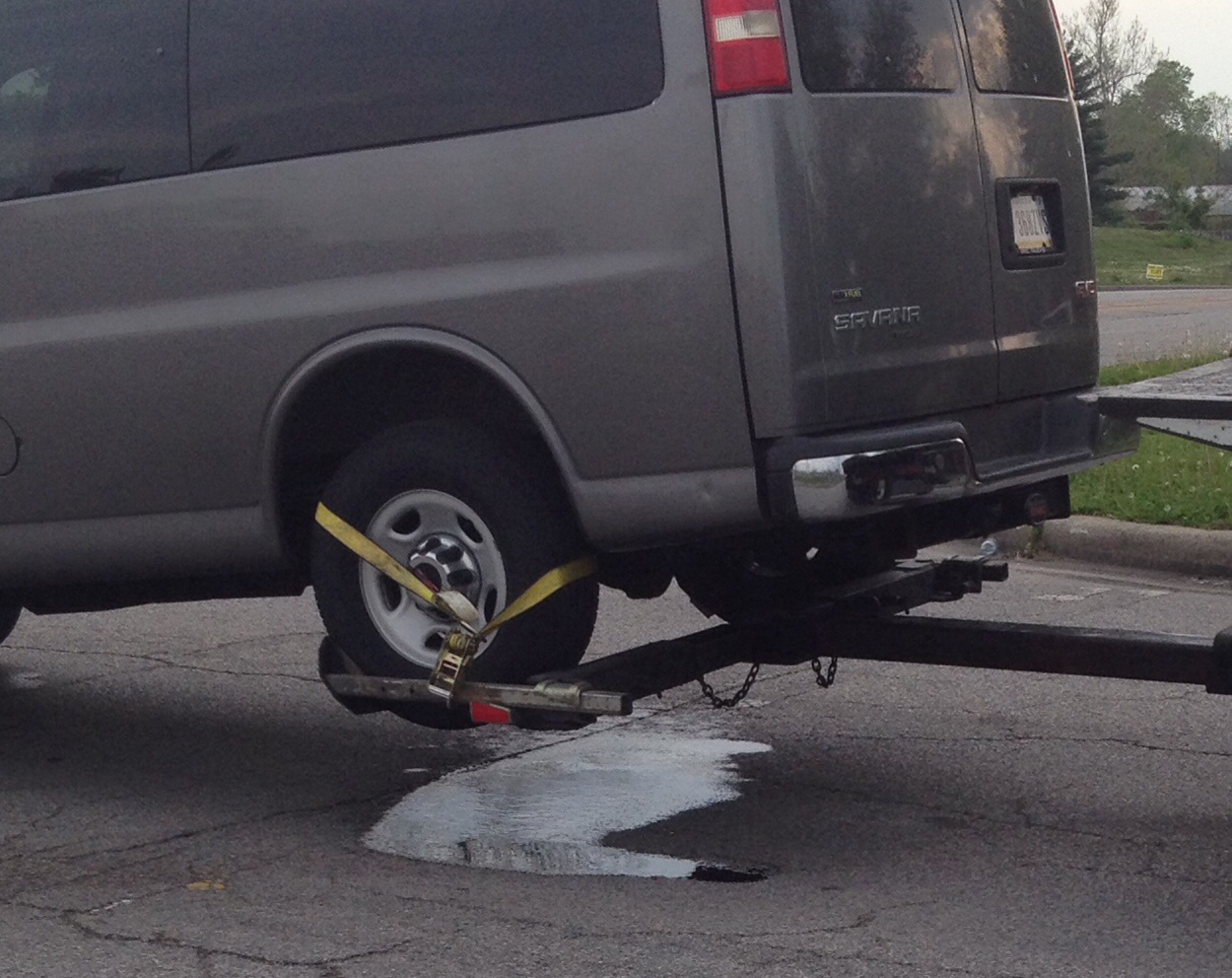

I also had no leaks, my driveway is spotless. The next image I have is the tow truck picking the van up. As stated before the diff sprayed fluid everywhere and evidence is all over.

Holy moly. Haven't ever seen that before. Did the pinion nut fall off?
That was why I questioned the original description. That looks like the pinion broke between the bearings. The spacing between the u-joint flange and pinion bearing looks to be still inline and about the correct distance. Had the nut come off, I would not expect to see the bearing still spaced correctly. If however, the inner pinion bearing came apart, the pinion would push itself towards the front of the van due to the gear angles I think. Still something I have never seen or heard of, to answer the original question.

The Mech told me the Pinion Gear actually "Broke"
Keep in mind that all I have is the picture to go on, but, to me it looks like the pinion gear broke either right at the point where the actual gear "starts" and the shaft "ends". Right at the point where the inner pinion bearing presses to, or just in front of the inner pinion bearing. Both spots should show signs of a defect in the metal. Would piss me off to no end if I was on month 65 of ownership and warranty ended at month 60, and mileage at 50% of warranty limit. Less than 10% out by time.

I seen something like that happen at a racetrack once. It was a pumpkin type Ford axle. The housing where the bolts holds the pinion bearings in broke and the pinion came out.
