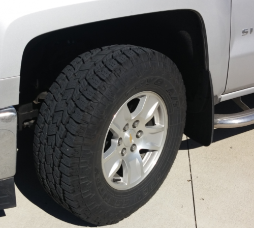

I'm running Toyo AT2 LT285/70R17's on my 2014 Silverado dbl cab 4x4 z71. Ran them on my 2005 also. They fit great, no rubbing. When I turn the front wheels at it's closest point there is 1 inch of clearance between the the tire tread and the inner wheel well liner. My truck is stock height, no lift or level. I can't imagine you having any issues on a leveled truck. Let me know if you'd like a few more pics.

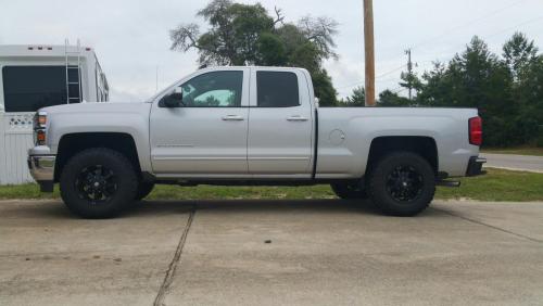

I'm running 285/70/17 Duratracs on Method NVs with a +0 offset. My truck has a 2" level and 1.5" body lift. No rubbing that I can tell.
Looks good man. That's what I want mine to look like eventually.
