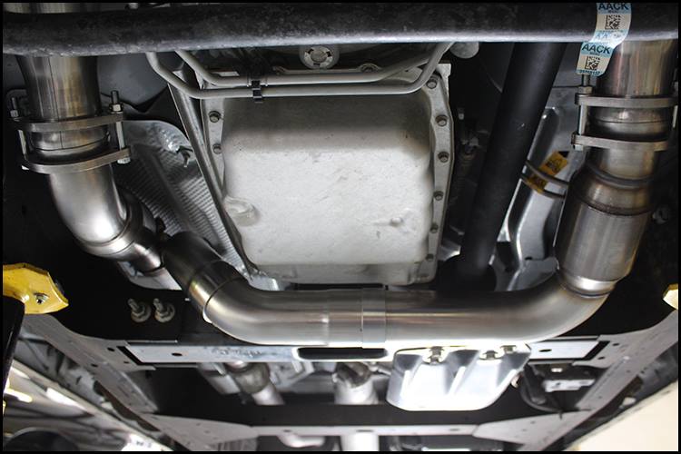

2015 6.2L 1500
No pics or vids or anything yet but with the stock catback I am really surprised and happy about how QUIET it is. It sounds like stock, honestly. Usually long tubes wake the neighbors. I installed the Kooks Y-pipe with high flow cats.
So now I am debating a catback, its not a no brainer for me to get one. I do not want a loud exhaust at all on my truck, I was worried I would have to install something quieter than stock.
Stock catback must be REALLY restrictive or really well designed....usually catbacks are good for 5 HP. If it is this quiet with long tubes.....could it be worth more????
Higgs... Same boat. Just picked up kooks/off-road Y. I'm gonna mate to stock exhaust because I really like the way yours sounded but I'm curious if your magnaflow is causing migraines and if you noticed any change in tune after new catback that would show any measurable increase in airflow?
The Magnaflow sounds so good. It doesn't represent on the video, it is super quiet at low throttle positions but sounds healthy, almost big blockish when you roll in a little bit.
I can't say enough how happy I am with this set up. Kooks LT, catted Y, Magnaflow catback. It's not too loud in any way.

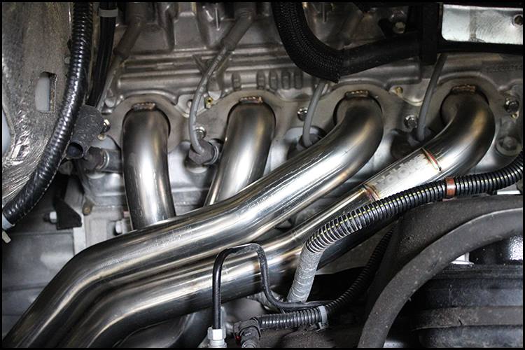

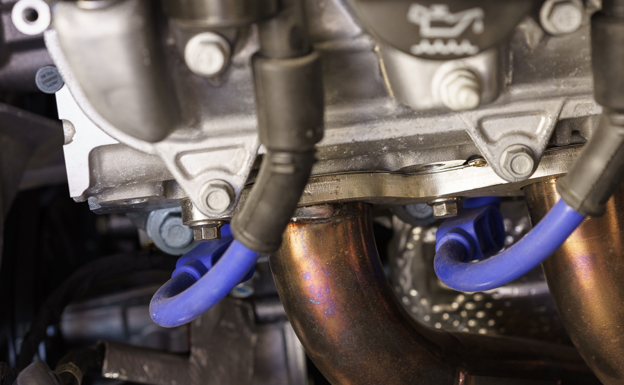

I'm wondering about access to spark plugs, proximity (heat) to other components, wiring, etc . Can you share your opinions and pix of your experience?
Better access to spark plugs
The only thing close to the headers is the plug wires but they don't touch.
On my car I run stock plug wires with heat sleeves and on the truck I have taylor wires without heat sleeves.
The Taylor wires can be arranged so that they have lots of clearance. I don't think you will have problems with either.
I could put sleeves on the truck but it doesn't seem necessary so I haven't bothered.

Here's a couple pics.
Good question, did you coat, shield or wrap anything or wish u had? Any noticeable underwood temp changes? Jet-Hot is about an hour away but I keep hearing that it's not necessary on Kooks, even from Nick at Kooks.
Nope, I would do it like this again.
Love the wires, I have been searching for a set and those look like they will work better on the passenger side front two cylinders. Got info handy?
