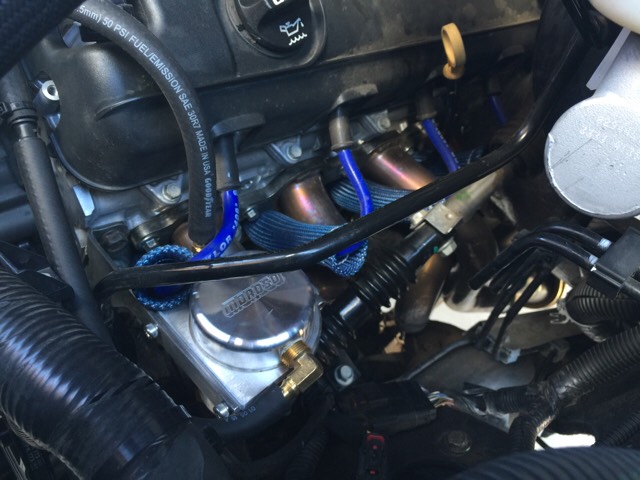

Here's a couple pics.
Nope, I would do it like this again.
Are you running straight boots on the plugs or 90 degree? Also, Taylor offers two different wire lengths as well, 9" & 12". I got the 12" wires since they say "truck" and the straight boots, they seem a little long. Also, I am wondering if the 90 degree boots would be better with the Kook's headers, as it looks like at least one of you use the 90 degree boots. Any help would be appreciated.

The curve of the 135 degree boots better angels them away from the headers.
