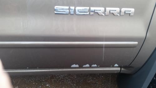

And yet another truck with paint problems
Was doing an hand wash on the truck last Monday night and well paint is peeling from the bottom of doors on both sides of my 2014 Sierra. Brought it to my dealer and the collision dept. manager was able to scratch more off with his nails. It will be warrantied but they can only take me in in a month in a half! I Love my truck but the fact that it will now have paint that's not original on it kind of takes the "shiny and new" factor out of it.
I don't trust body shop paint will outlast what original paint is expected to and will more than likely be looking to trade that truck in earlier than expected for another make before the "new paint" starts to peel again.

GM does know about this issue. Happens on Ft. Wayne built trucks built before 5/15/2014. PIT5313C: Paint Peeling Above Anti-Chip Area.
Thanks for the info. The collision manager was telling me he never saw this happen before. Will email him this number see if he can do anything with it.

Just to give an update. After waiting 6 weeks for my appointment, truck spent 16 days in the shop and the job was not acceptable. Was told they can take it back at the end of September so had to write a nasty email to the service manager and now it's back in. Keeping my fingers crossed that it will go better this time.
