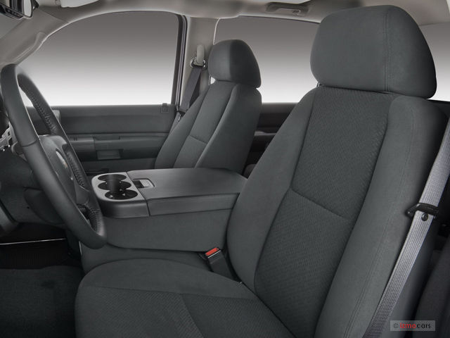

We just traded from a '99 Silverado LT (fully loaded) to a 2008 LT2. My wife was disappointed that the new truck had less features
than the old one. Soooo, I have added:
  • splash guards
  • running boards
  • cold air intake
  • dual exhaust with Magnaflow muffler
  • new Ruff Tuff seat covers (to refresh the sad looking cloth seats)
Now it looks better, is much more comfortable and runs better too.
