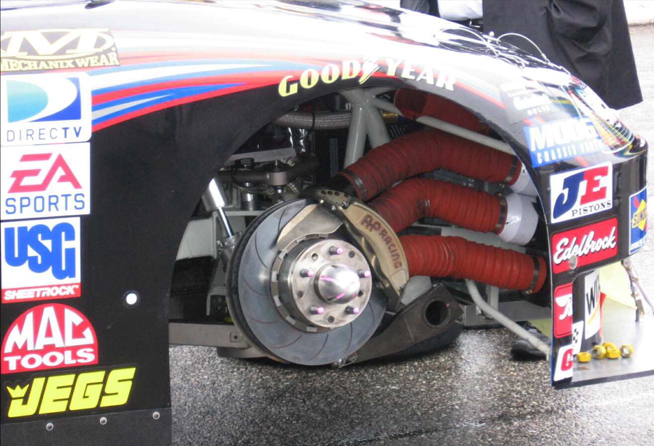

Oh and by the way, in NASCAR they use OVERsized plain rotors in leiu of drilled or slotted in order to increase surface area. I stress the term OV ERsized. They dont worry so much about overheating because of the size of the rotor and the fact they have blowers to funnel air directly to the rotor and caliper.
YEP, huge NASCAR and NASTRUCK fan right here!
I knew they use blowers and they don't care for longevity since the brakes are one of a lot that are replaced every race. I just thought they were slotted in some way, even if the slots weren't as long or deep as you see for street use. I know you've seen how they will glow red hot at some tracks. But, I figured at the high braking tracks like a road course or Pocono they might use slotted. I know they use huge 6 piston calipers on high braking tracks and some of the tracks like a plate track they might only use 4 piston calipers. I wish I could go to a race and go in the pics during practice so I can get a good look at some of the stuff they run. What's sad is that I'm an hour and a half south of Richmond and never been there for a race.
I am glad you brought that up, I never really noticed it before. The last time I had a chance to look at the rotors personally they were plain with huge surface areas and central venting. Seems now they have incorporated slots.

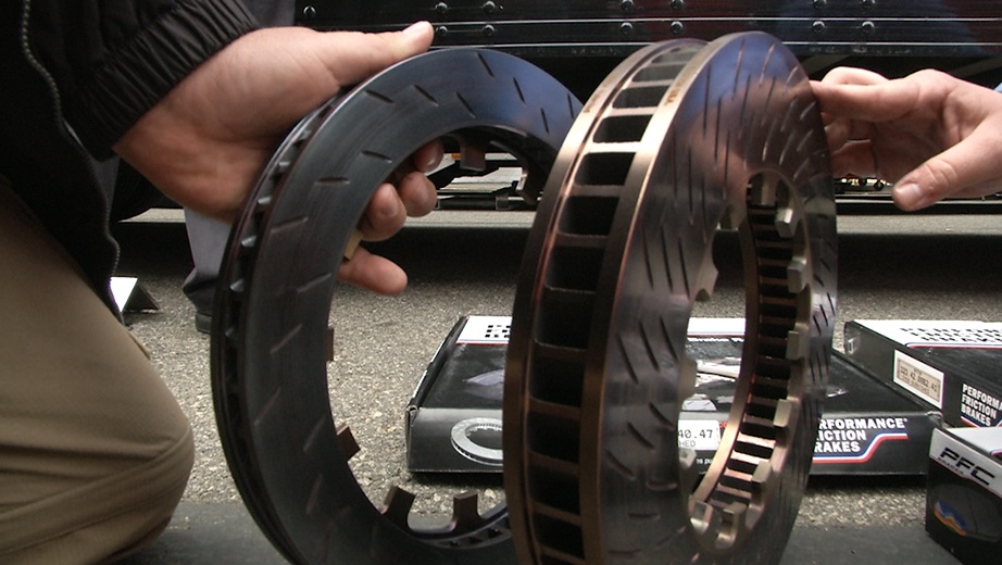

As I tried to point out earlier, the reason NASCAR didn't used to use drilled or slotted was because they did not need to. The use oversized plain rotors with huge center air channels and blowers. What I have noticed now is that the rotor is smaller and they have started using slots.....that was the point of the picture. Now you have to ask yourself, are they doing it for looks? Is it going to fail? Are they durable? Will they slow you down from 190 to 55 in the blink of an eye? Yes is the answer to everyone of those questions. Now transfer that to the street....of course their using multi thousand dollar brakes. But if you benefit from 3% of that technology, that 3% you didn't have yesterday. Once again the question goes back to you and whether you are will to spend the money for 3% improvement or not. For me I think it's at least 10% and I am satisfied and there's not a Muldune on here that's gonna sway me otherwise. Experience trumps inexperience every day of the week and twice on Sundays!
