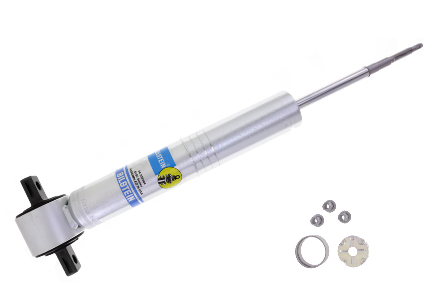

Thanks for the advice. I did some more research and I think you guys are both correct. I just placed the order for 2 Bilstein 5100 (24-238304). I will also replace the rears with Bilsteins but I need to figure out the part number.

Its the best way to level at a decent price. The rear shocks are part # 33-238319 You can order at suspensionconnection.com and they have 10off100 20off200 30off300 right now. Let me know what you think after. They were back ordered when I leveled mine so I used a spacer. Just ordered my bilsteins and they should be here tomorrow so I can get rid of the spacer.

I found 24-238298, why is that different than the part number you provided? Is yours for the Bilstein 5100 and mine for the Bilstein 4600? What's the difference between the 2? Which would you recommend for this project? I don't plan on lifting the rear at all.

The part number I listed is for the 5100. the rear shocks will not lift the rear at all only the fronts will and they have to be the 5100 in the front because they are adjustable. there is no big difference on internal components between the series just the outside looks. So I would go with the 5100 in the rear as well because they look better being zinc coated with a brushed look vs the yellow 4600s. The way they describe the difference is the 4600 are really meant for stock height trucks with no modifications where as the 5100 are meant for leveling and lifted applications.

So... If I went with Bilstein, the MAX I can lift the front is 1.85" and the rear 1", correct?
So if I wanted more of a lift (2.5"), I'd be better off going with a level kit, since you can't combine a level + bilsteins... correct?
If you want more more of a lift you should really be going with a lift kit so you're not maxing out all your stock suspension components.
