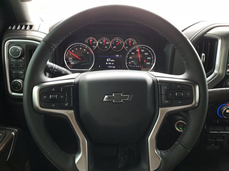

Steering wheel is not centered
I've always felt like the steering wheel was a tad more to the right than the left myself... I must be the odd one out. It feels like when I center my head with the headrest, the steering wheel is slightly off-right. Also, when driving, I can rest my arm on my center console (jumpseat) and my right arm be closer to the wheel than when I rest my arm on the door armrest with my left arm.

Mine's off about a half inch to the left after the 3-inch lift on 2019 Silverado rst  so this can be fixed the dealer told me it could not be adjusted anymore that it was maxed out
^mine was like that when I bought it, dealer fixed it and with with my recent tire rotation / oil change they re adjusted it without me even having to ask. Perfectly centered. To be fair tho darn near every vehicle I’ve purchased has been off to some degree and sometimes they just shrug and say sorry. This Chevy dealer has been better than most about it.

I put a 2 in level with 295/60/20 on my 2019 LT and now the steering wheel is a little off center to the right.  The steering wheel was perfectly centered when I bought it.  I had the alignment and leveling done at a local shop which has good reviews.  The guy at the shop really tried but couldn't get it perfectly centered.  We tried four different times and three of the times we went on test drives together and kept adjusting it each time.  I'm tempted to take it to the dealership and try to center the wheel but I don't know what else the dealership could do... Truck looks good and drive straight but the slightly off center steering wheel is annoying.  This is the kind of stuff that makes me not want to do anything to my truck but it's so hard to leave it stock and it looks much better with the level and larger tires.  it does make me feel a little better knowing other people have the same issue and it's not just me.
