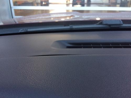

Having the steering wheel turned off center when going straight down a level road would irritate the crap out of me. Probably almost as much as my plastic dash piece sticking up right in my line of vision "pic" >
dealer replaced the plastic piece but the new one sticks up a bit too no fasteners in that spot. I thought that while you guys were looking for the steering wheel centering problem that if you could not find that you might enjoy the lose plastic dash piece. Have Fun.
