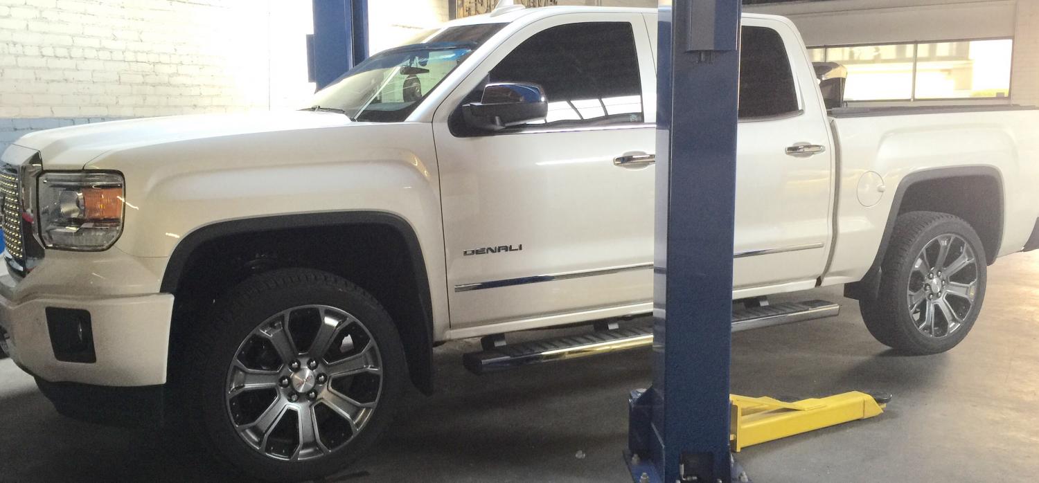

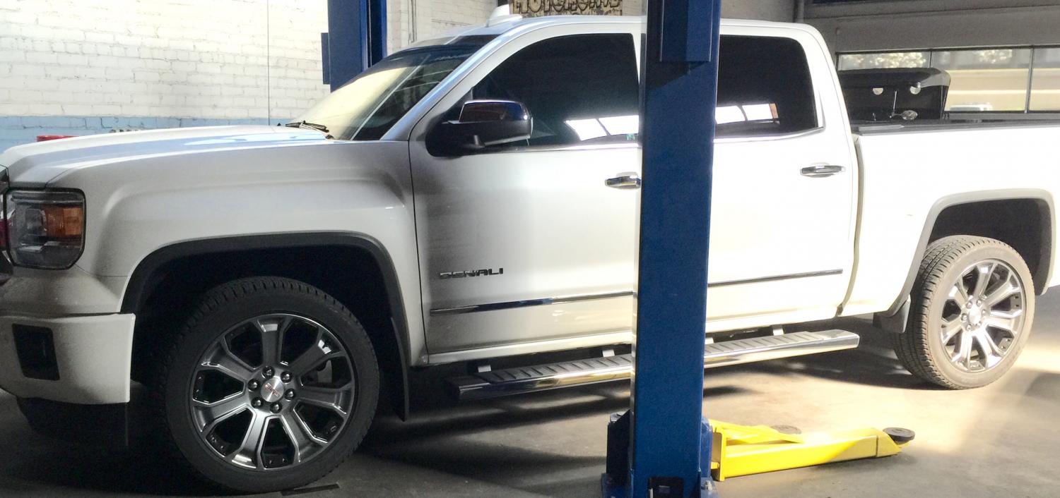

I installed the Motofab 1.5" level kit on my Denali today. I also used a 1/4" steel spacer to shim up the Magnetic Ride sensor arm plate. I did the right side first so I could verify the arm retained the same geometry as the unaltered one on the left side. I'm happy with the way it looks unloaded, but after I had the front end aligned, I picked up my small trailer that was loaded with a sod cutter. Just those alone made the nose pitch up. Nothing crazy mind you, but I was happy to disconnect the trailer!
