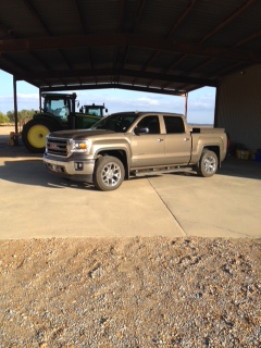

I have a 1.5" level with 275/65r20 open country. I like it so far front fenders are both 38 3/4" rear is 39.5" just a very slight rake.

I Raised mine 1.25 inches with 1/2 inch blocks under the struts. This leveled my truck but I have loaded toolboxes in the rear all the time.post-137309-0-09073000-1450719770.jpeg

I don't remember the exact numbers when I measured my fenders but I still had a noticeable rake you can see in my pictures above.
