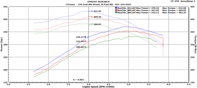

Stock- 332/383
Tuned - 353/409 picked up 21whp and 26 ft/lbs over stock
Tune E85 - 370/432 Picked up 38whp and 49 ft/lbs over stock
15%206.2%20wintake%20stock%20tuned%20E85
And that still with 2-3 gallon of premium gas mixed with the 10 gallons of E85, a pure tank of E85 might be more yet!
