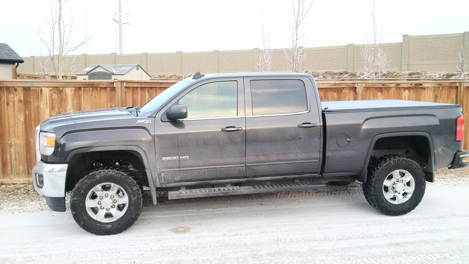

Installed 295/70-18 Nitto Trail Grapplers this weekend, and Leveled the truck. I just cranked the stock keys,went 5 1/2 turns which got me 1" of lift. I'll book it in for an oil change and alignment weekend coming up. Might give it a few more turns during the week, we'll see. I must say though, in my opinion the ride is much better.

Your truck looks really good by the way!
Thanks!!
