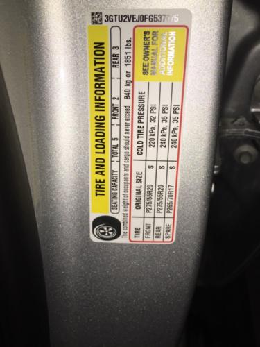

Check the drivers door tag
Duhh...I was looking at the axle and gvwr tag and never thought to check the tire tag.
It's on 20's and lists payload at 1803 lb.

Payload is 1,851 lbs. though there is already at least an extra hundred in stuff in and on the truck before gearing up for a trip.

1851 for a max tow....seems low
