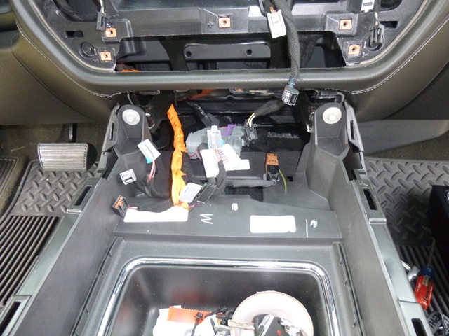

I have a 2015 crew cab with 2,000 miles on it. At about 500 miles it developed an annoying rattle when you go over rough pavement that's hard to pinpoint but sounds like it's coming from deep inside the dashboard, behind the HVAC controls, and maybe a little towards the passenger side. I've tried all the fixes for interior rattles that I could find posted on various forums with no luck, so I started removing one part at a time and test driving to see if the rattle went away:
- "A"-pillars
- Windshield area defroster/speaker trim panel
- Trim around touch screen
- Touch screen
- HVAC controls
- Power pedal / cargo light / etc control panel
- Upper and lower glove boxes
- Black plastic shroud under lower glove box
- Sunglass holder clip

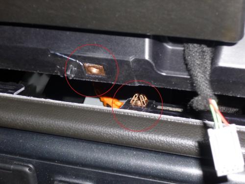

Then I had a passenger use a stethoscope with a rod end to try and locate the rattle, again with no luck. One thing I did notice was that there are small black hex head screws everywhere that you can remove with a 7mm socket. Every single one seemed to be barely snug. They screw into copper retainers with two wings that fit loosely into the dash. They SHOULD be tight when the screws are in place but I found one behind the cargo lamp light panel that connects the dash to the center console that was jiggling in it's hole even though the screw was installed! I couldn't reach the head on that one so I spread the two wings till it was tight in it's hole. Seems like at the factory the torque for the equipment that installed these screws was set too low or something. I tried tightening all the screws I could find (including under the fuse panel by the passenger door) but there are so many of these that I'm sure there are ones buried somewhere that I can't see. I think maybe one of these is loose and making the rattle, or at least the noise they make sounds similar to the rattle. This is driving me insane and I'm tired of giving people rides in my new $55K truck and having to listen to "hey what's that rattle? Isn't this brand new?". If anybody has found the cause of this rattle I'd LOVE to hear it, thanks.

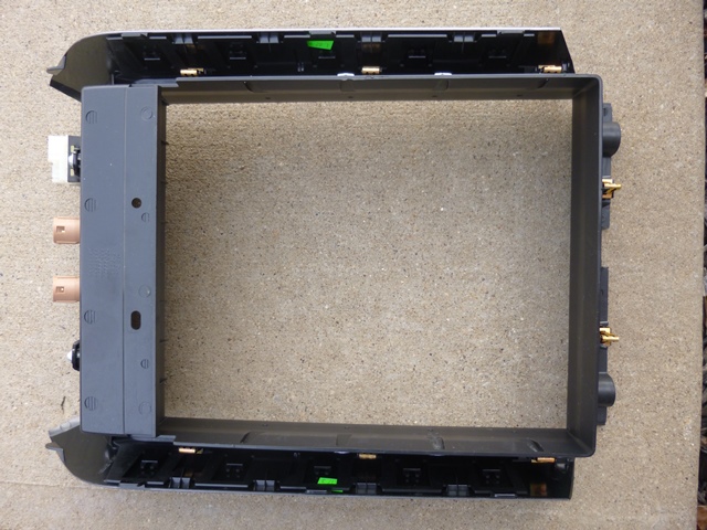

FINALLY - SOLVED!! It's the 120V AC plug where the center console meets the center dash. I removed the center console trim piece and could shake it and hear something rattling in it, the trim piece is just held in place with the snap-in tabs, here are pics of the bottom of it and the end of it where the power outlets are. The 120V outlet has 2 plugs that go into the back of it. The plugs come out by using a small screwdriver to press in the tab on the side of the plug. Then remove the outlet from the trim piece by pushing in the 4 straight plastic tabs on the sides of the outlet. Once it's out, remove the back by prying up the 4 U-shaped plastic tabs. The back assembly includes a little circuit board with copper receptacles. Trapped inside each of the 2 receptacle is a white plastic piece with a spring behind it. The copper is not tight enough to keep the white pieces from banging around. I just used needle nose pliers to squeeze the tabs together tighter until they stopped being loose, but not so tight that the white piece didn't move freely. While the trim piece was out, I put duct tape in a few places just in case, but I'm not sure it was necessary. Put it all together and now my truck feels solid as a tank again. You're welcome for the free root cause analysis and corrective action, GM. My invoice is in the mail. (I also took pics below of what the center dash looks like naked, sometimes that's helpful for other things so here you go.)
