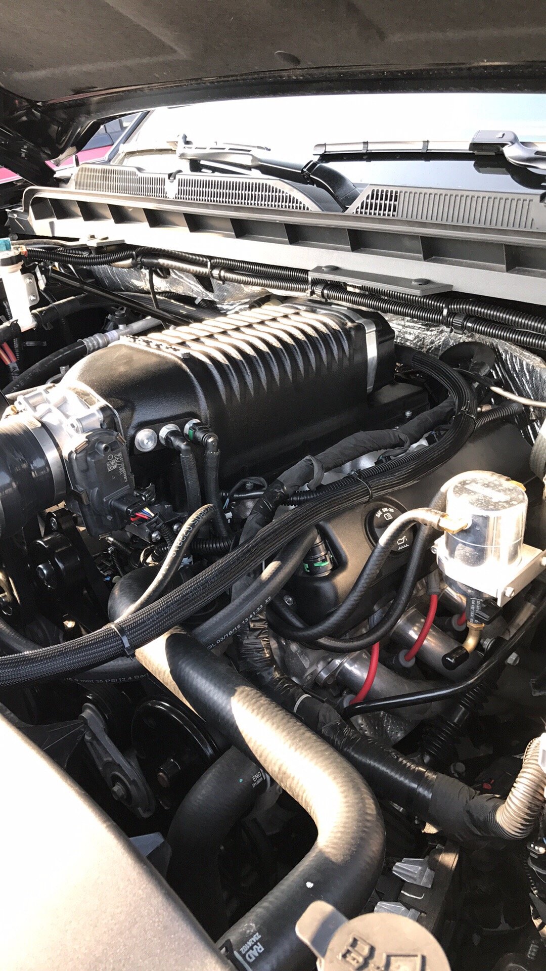

Hey guys I’ve been watching these forums for a while now and figured I’d chime in!! I have a 16 Silverado that I bolted a whipple supercharger on. Kit came with the 4.3 pulley boosting at 6psi with my longtubes. Put the 3.875 pulley on and now we’re boosying a constant 10psi fluctuating to 11. Have had no issues with fueling, we leaned out a little on top end and added 15% more fuel and was waaaay to rich. Ended up taking 13% away again. 10-11 psi at 11.8afr. Truck also has longtubes, full exhaust, catch can, caltracs, Hoosiers, pillar set up. Put down 512whp and runs a 12.6 in the 1/4 @ 109. In my opinion fueling on these new gen v trucks is good for 600whp if not more. Just ordered a smaller pulley for 2 more psi, snow stage 1 month, lt4 throttle body and Lingenfelters 2 step. I will let you guys know how it goes! Also you can look my tuner up on face book at lsx guys or Dedrick’s auto service. Any questions feel free to ask.

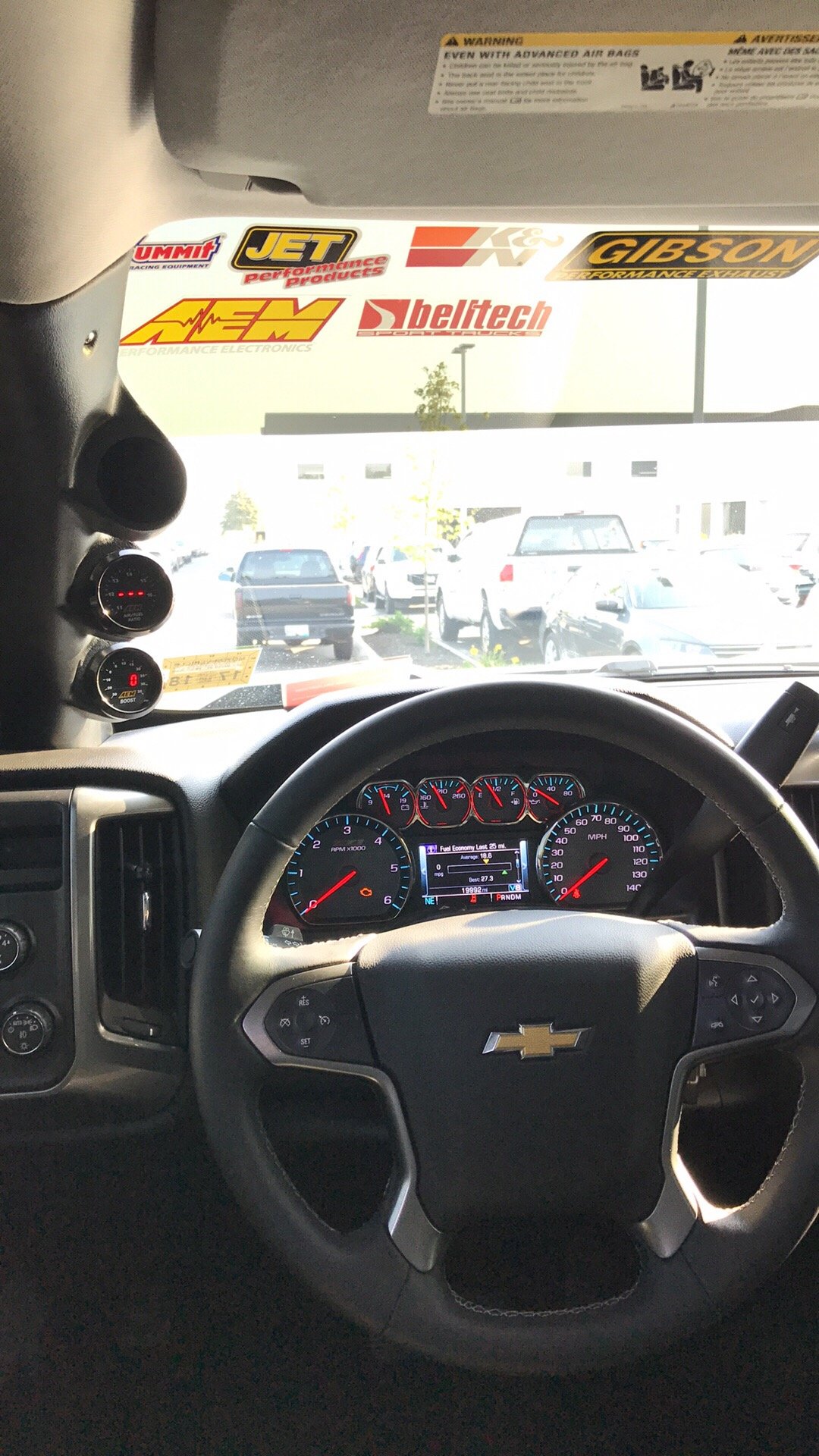

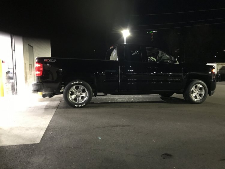

I was just reading the comments regarding putting a blower on a 5.3L . I just did this past summer and I love it , I like the torque and increase of power. If you have the means id say do it. Here are some pictures. Let me know if you have any questions
