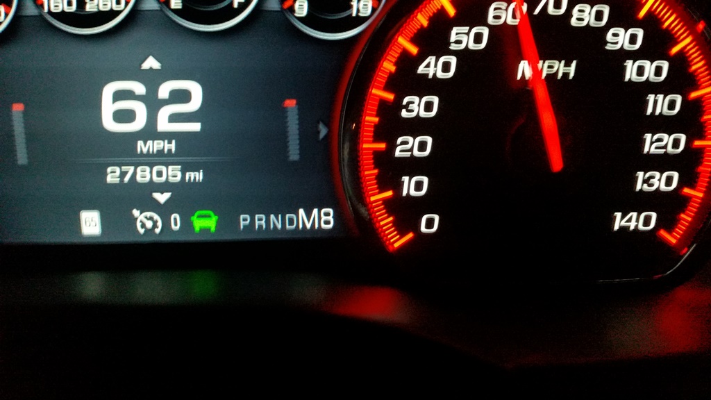

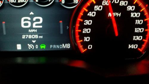

Does your cluster not show the gear number to the right of the "M" as seen in the attached image I took of mine?
I'm confused by the two bolded items in your quote though. For me, it shows the gear I'm in and allows me to shift up or down manually. I mean it's not like it makes it a true manual transmission but it does give more control than when in drive. Is that what you were wanting out of it, for it to be a true manual?
Mine says the gear selected... like yours. Now maybe Denali's show what gear the trans is in and actually follows as it shifts.... but by the looks of it i doubt it. My M mode is no different than the column shift in my 05. I can select the highest gear it can shift too and force down shifts. Like just because it says M7 doesn't mean it's in 7th... it could be in first, third... whatever... it just can't shift higher than 7th. Your truck will work the exact same way... you can't be in M and tap the plus sign and have it up shift if the truck doesn't want to allow it. Like I said... it's good for locking out afm and making it shift down.. that's all.
Sent from my SM-G900W8 using Tapatalk
You can force a downshift in M, but not an upshift. (even for downshift it verifies that it won't overspeed before performing the shift)
It's easy to verify if the display is showing actual gear or max gear.
After setting to M8, find a place to stop the truck. If it doesn't show M1 when stopped and when restarting, then it is just showing the 'max permissible' gear.
