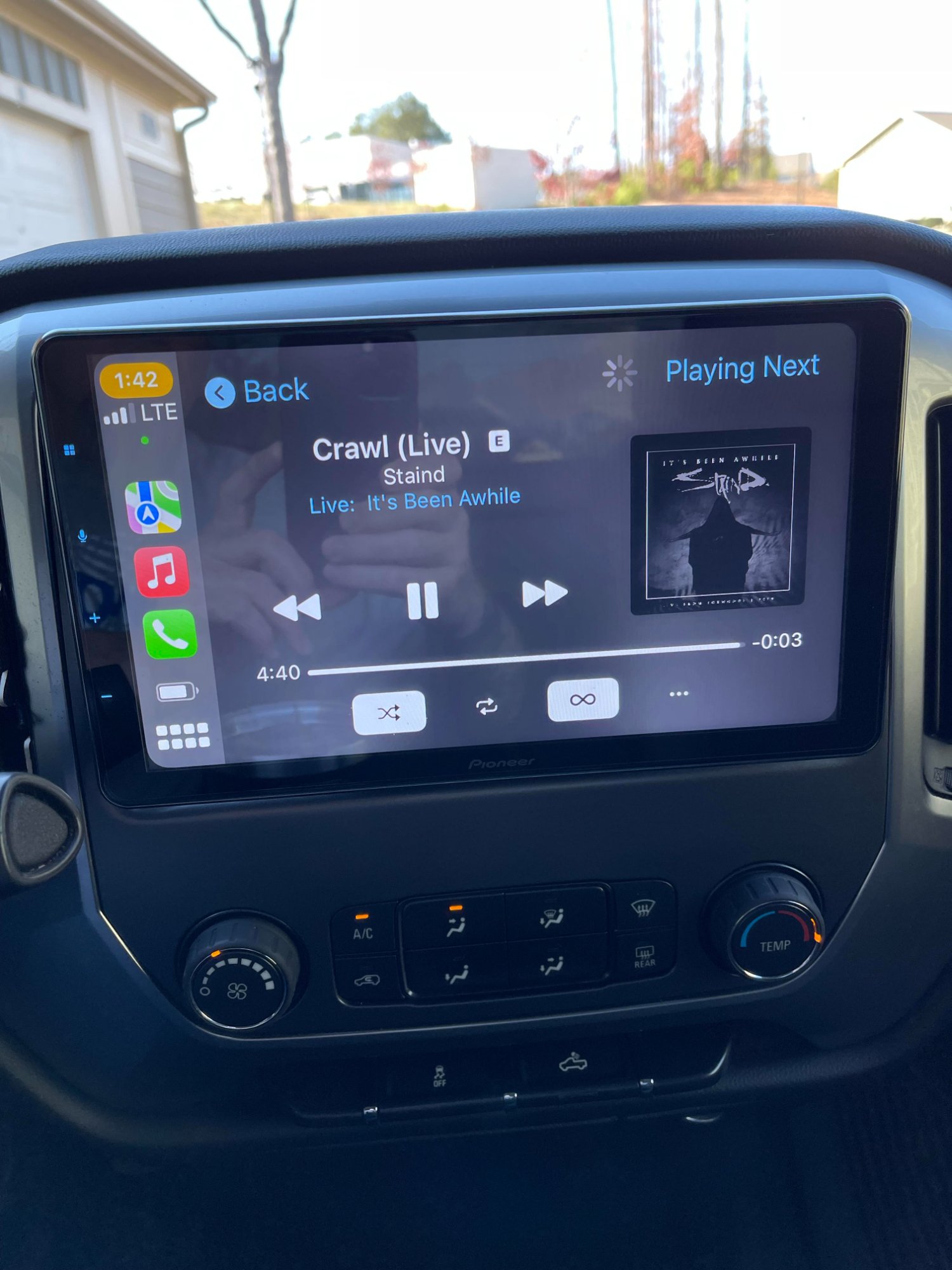

I first installed a Pioneer 4200NEX with the 7 inch screen but now I have the Pioneer DMH-WT8600NEX 10.1 Floating screen unit. I love the unit so far. It can connect wi-fi, BT, wired/wireless CarPlay. Single DIN chassis and it was very easy to install.
System consist:
Pioneer 8600NEX
PAC RP5-GM51 Interface
Kenwood KFC-XP6902C 6x9 separates for the front stage
JBL Club 6420 4x6 for the rear stage
Pioneer GM-D1004 brick amp mounted under the passenger seat 100wx4
Rockford Fosgate P300-8P 300w powered subwoofer
Small system, but sounds awesome
