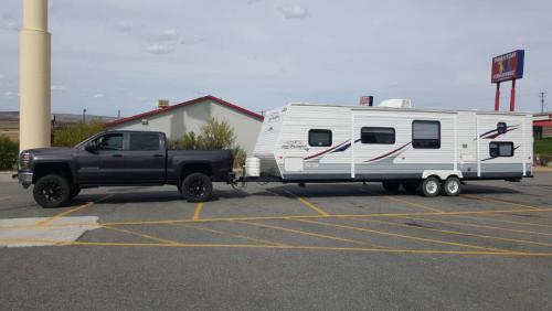

Just makes going into 6th happen less "if" you're dealing with a lot of hills. If I don't drive like an **** I can still get 16mpg. And a lot of guys will say it puts too much stress. But I don't think so. I pulled a 10klbs trailer 1680 miles in two days without any abnormal heat. I will eventually get different gears. But I'm not worried about it right now. post-137629-145611049804_thumb.jpg
