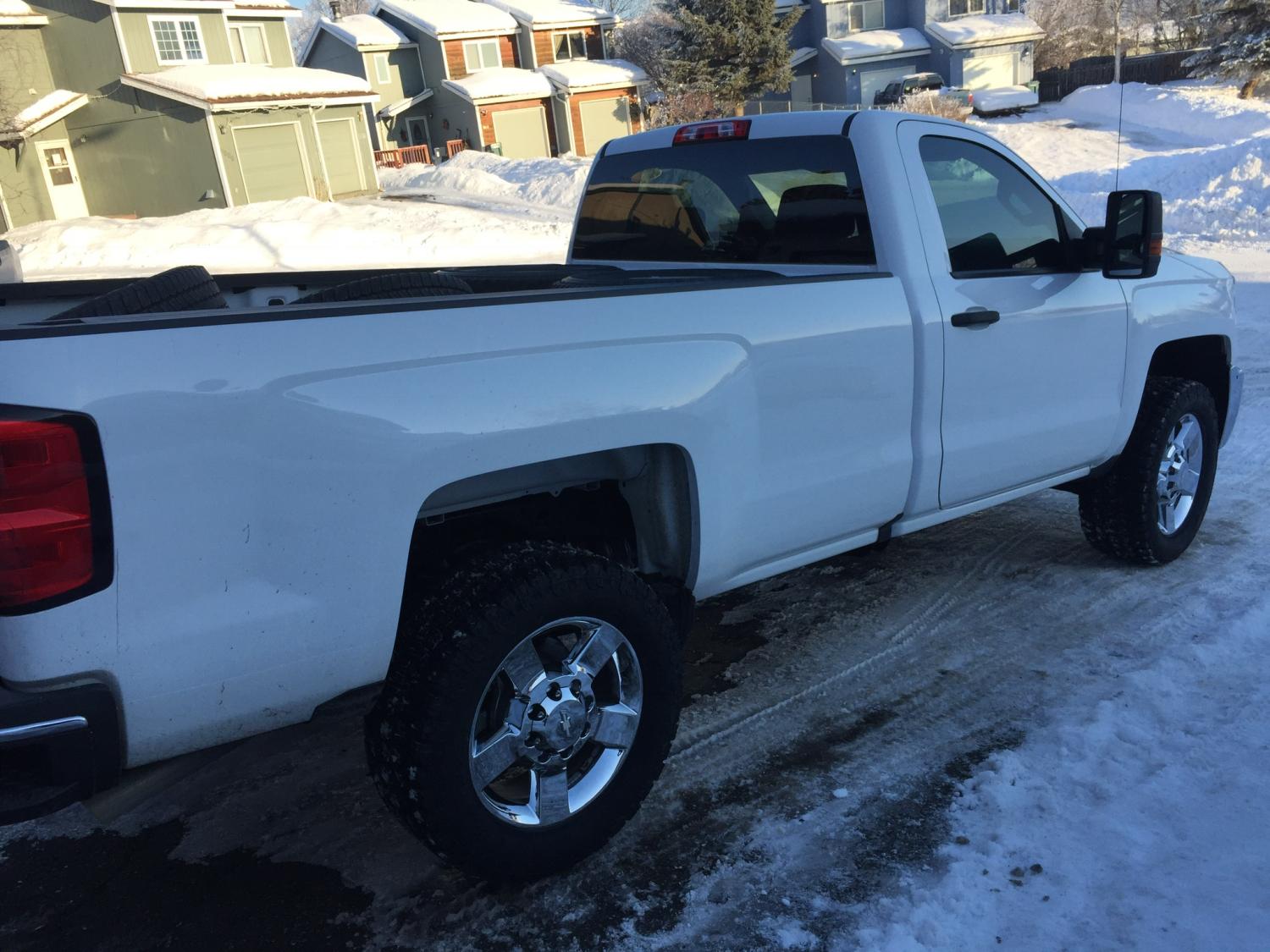

I bought these wheels and tires for 600$ and put 305/55/20 Toyo at2 on my truck today had to clean and polish the wheels post-168988-0-20361300-1486516453_thumb.jpgpost-168988-0-56768600-1486516478_thumb.jpg
