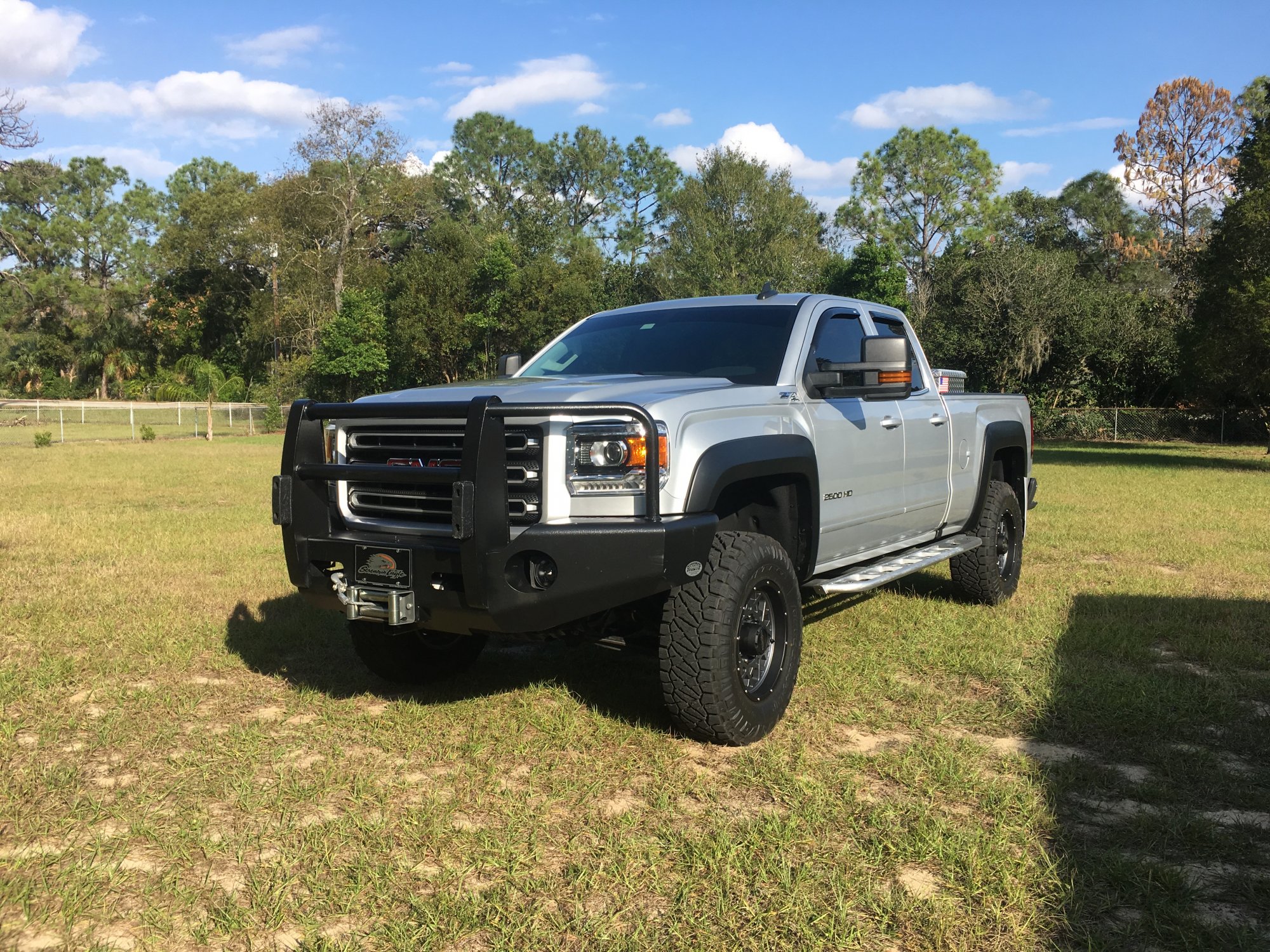

What steps are these? Truck looks good!
Thanks man, Chassis Unlimited rock sliders, welded on. They are pure beef, rock solid steps, way over kill. Side crash protection might or might not be better...
I like them, no one else has them, they're 7 feet long, grip tape on the back to help get into the tool box with out slipping. There's like 500 lbs of added metal to the truck in this phone picture, put on Bilstein 5160's on the front, and they are great.

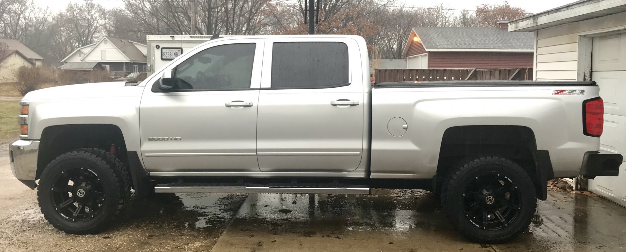

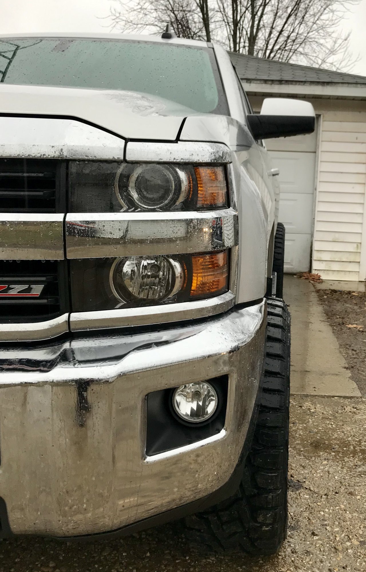

Signed up just to put this to rest. I took the plunge and put Nitto Ridge Grapplers on today in 285/65R20. Stock Duramax Denali wheels, no lift, no level, I only removed the lower air dam/valance. Zero rubbing at lock, forward or reverse, and no crank on the T bars
2015 2500 for reference
I hope this helps someone else since I searched forever and couldn’t get a good answer.

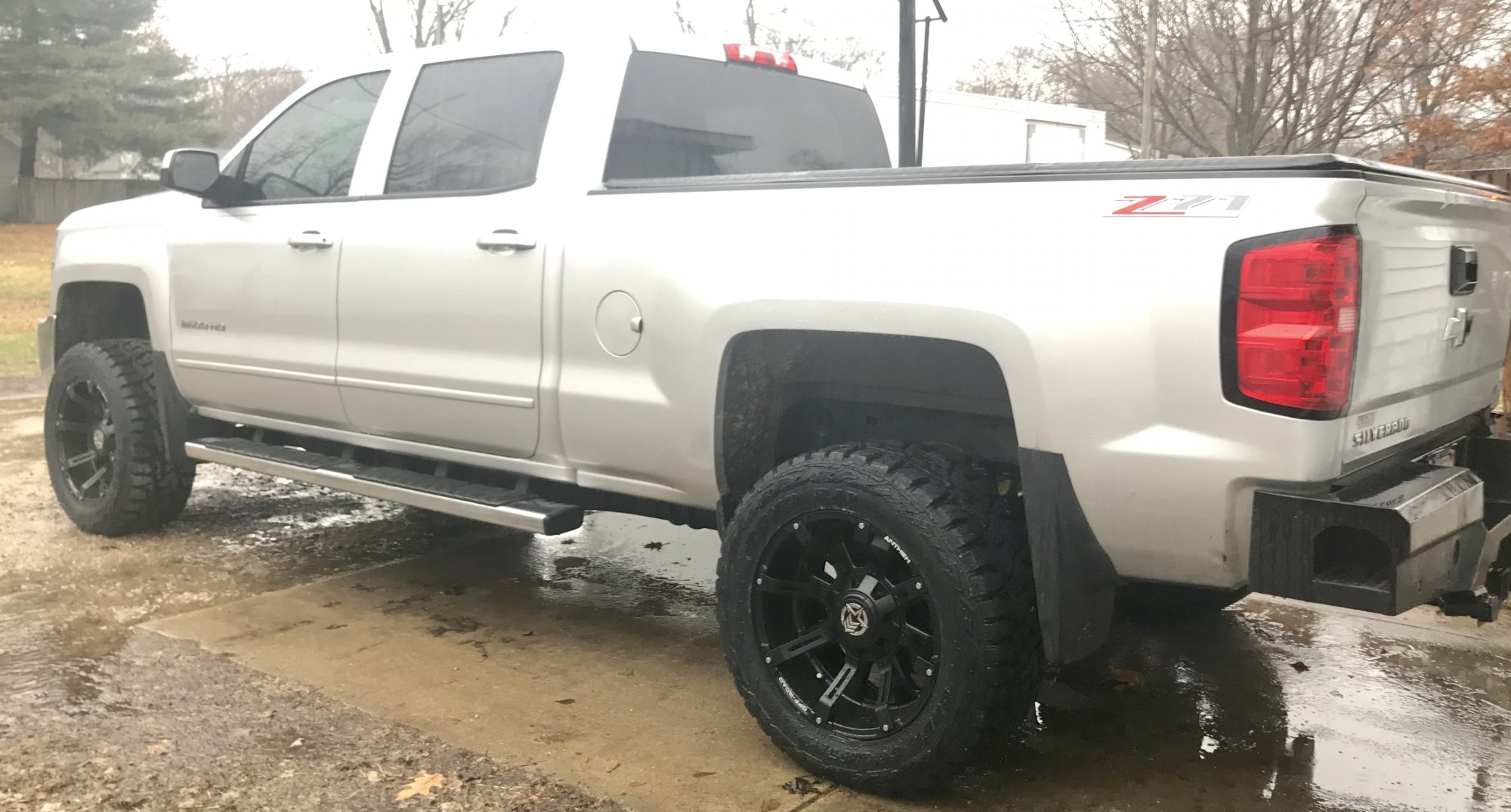

Hey guys,
I wanted to add my recent setup for reference.
2015 2500HD LT CCSB
Bars cranked up 2” and will be adding blocks in rear next to add a little more rake.
20x10 (-24) Anthem Off-Road A712 Defenders wrapped in Toyo Open Country RT’s in 305/55R20LT.
Trimmed lower valence and front bumper where it meets the valence.  Need to work on the fender liner front and rear of the front well and trim front factory mud flaps up near their innermost mounting point.  Should be good to go after that.
Keys are cranked almost all the way so I may go with an aftermarket key set.  I also have front shock spacers and a front differential drop spacer kit to install.
