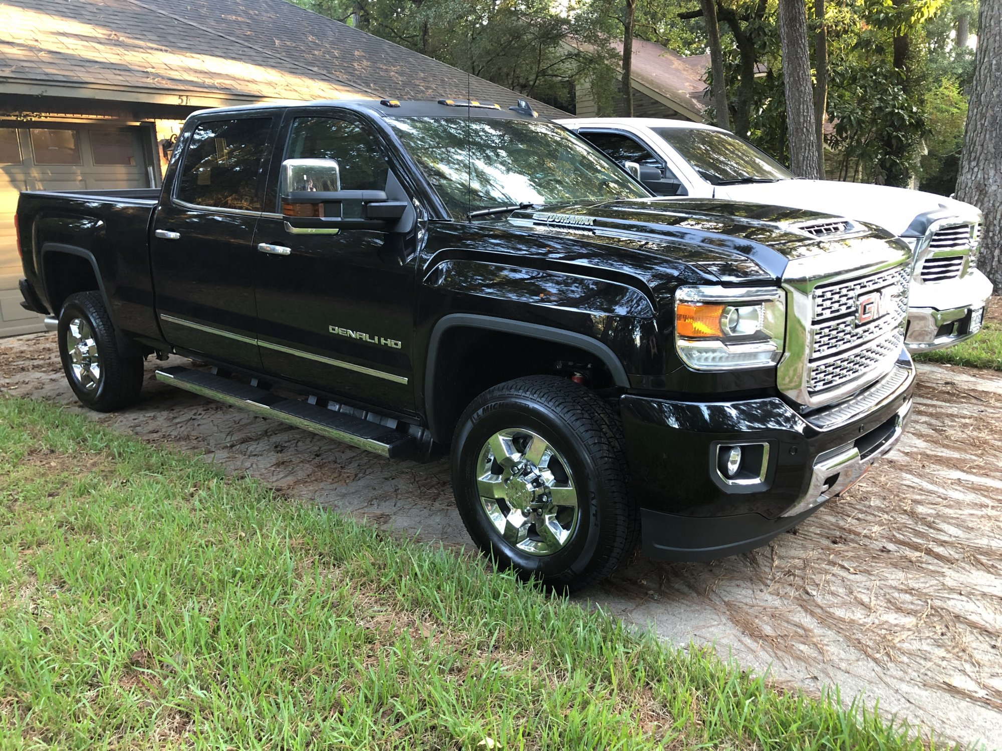

Update on my truck; 19 Denali 2500HD, put 2" leveling kit on and brought it up 1 7/8" (drivers side maxed out). Front measurement is 42 1/8" and rear is 43 3/4". I am happy with how it sits, the upper control arms are not touching metal stops and I didn't use shock extensions either.  Also the ride is exactly the same and my steering wheel hasnt moved, so not sure if i need an alignment. I ordered MHT Sledge's 20x9 +20mm and hoped to fit LT285/65/20 Goodyear ultraterrains from Discount Tire. Today they did a test fit and it barely touched the inside of front fender liner and rubbed the factory mudguards, I have the factory flat/flexible guards. I probably could of done some trimming to make it work, but I am gonna try the 275/65/20's in the same tire. That 285 was taller than a 35 when side by side, weird.... I saw 2 more trucks like mine this weekend, both T bars cranked and UCA sitting on metal stops and one had 305/55/20 and other was 35-12.50.20 with trimming. I just dont want to mess with the ride quality and have it sitting on metal stops.
1 7/8" lift in front and flat OEM splash guards, 20x9 +20MM wheels, 275/65/20 Goodyear Ultraterrains. Had to slightly modify front splash guards becauase barely rubbed at full lock.
