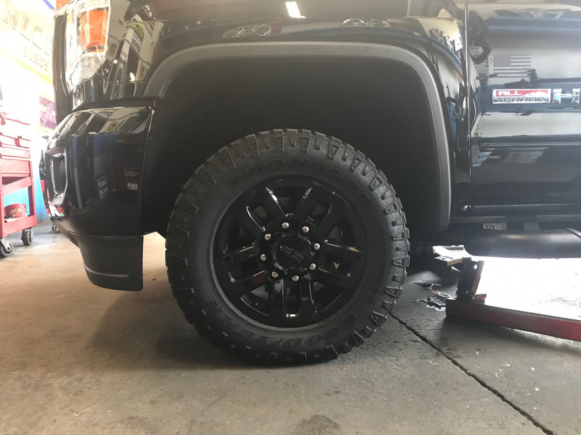

I have LT295/70R18 on my ride now.  They're a 34.29"x11.77" tire and I don't have any rubbing.

1 hour ago, F-16 Driver said:
Sweet ride!  I have the same truck without the bars.  I'm considering the same size Duratracs.  Still no rubbing?  Even at full crank?  How's the ride?
No rub at all, forward, backward, lock to lock. Rides smooth. I haven't been camping yet this year, but been over a few curbs lol.

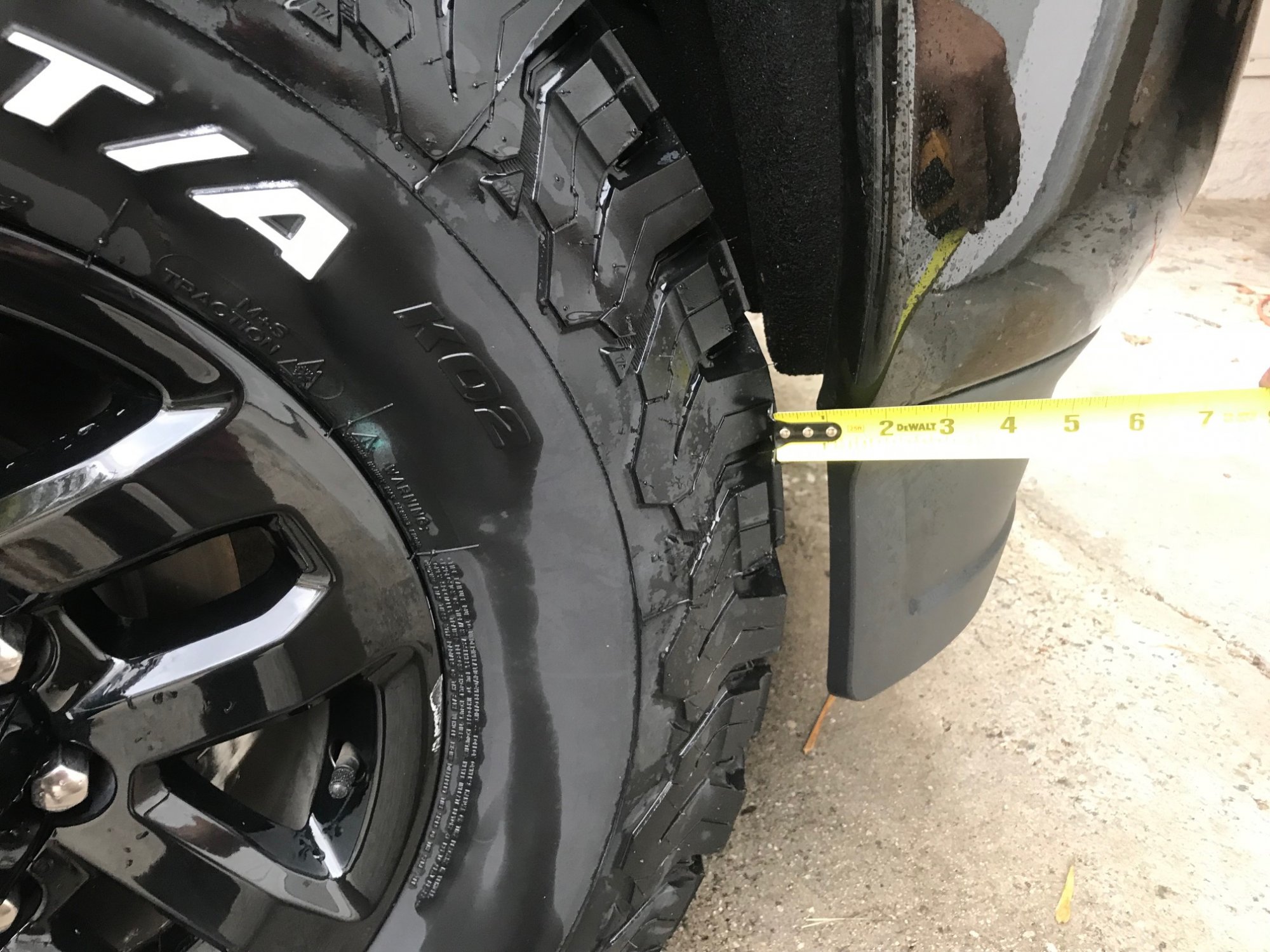

BfGoodrich All-terrain 35x12.5x18 on stock 2500.
Rubs chassis at full lock, I tend to avoid bouncing off full lock already. Was thinking of going with the rancho 4.5 kit since it says you can use your stock wheels.

Any more pictures of that available?

Here you go:
Wheels turned to the point of minimum clearance (9 o'clock to the left / right on steering wheel) still has 1 inch of clearance.
multiple trips this weekend with a trash trailer (5k lbs), still was able to get around the yard in tight spaces without rubbing - just avoided the last 2-3 inches of full lock on the steering wheel.
