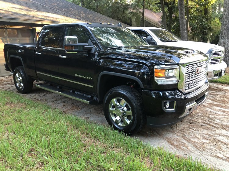

Just got a 17' GMC Denali HD. Stock 20's want to turn up the forks on the front and fit 325/60r/20 bfg mud terrains. Will this work? Thanks. Off-road package and no mud flaps
Definitely way too big. I couldn't even get 295/60r20 to fit with my front end cranked up. I'm after market with a x9 instead of 8.5. I've heard some cases of guys fitting 295 and trimming and such... but that 325 won't fit.

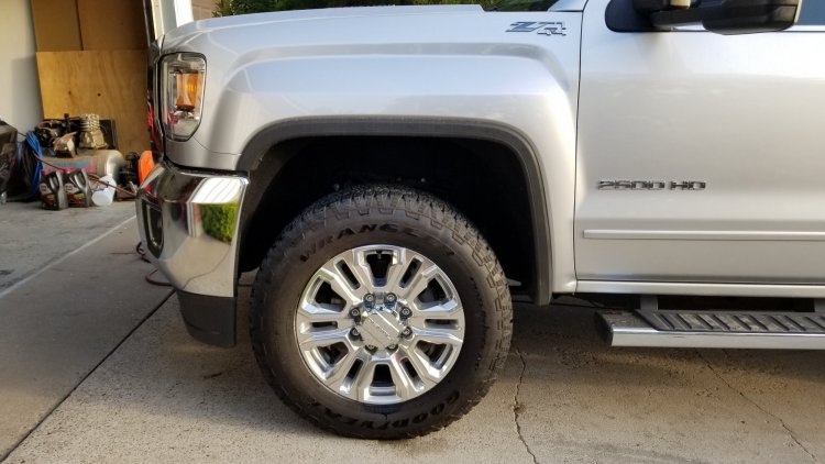

Just installed 285/75r18 Duratracs, 2017 Z71, stock front, rear shackle lowered. Absolutely no rubbing and fills the front end right up.
Nice! I really didn't think that size would fit without raising the front end a little. Looks great!
