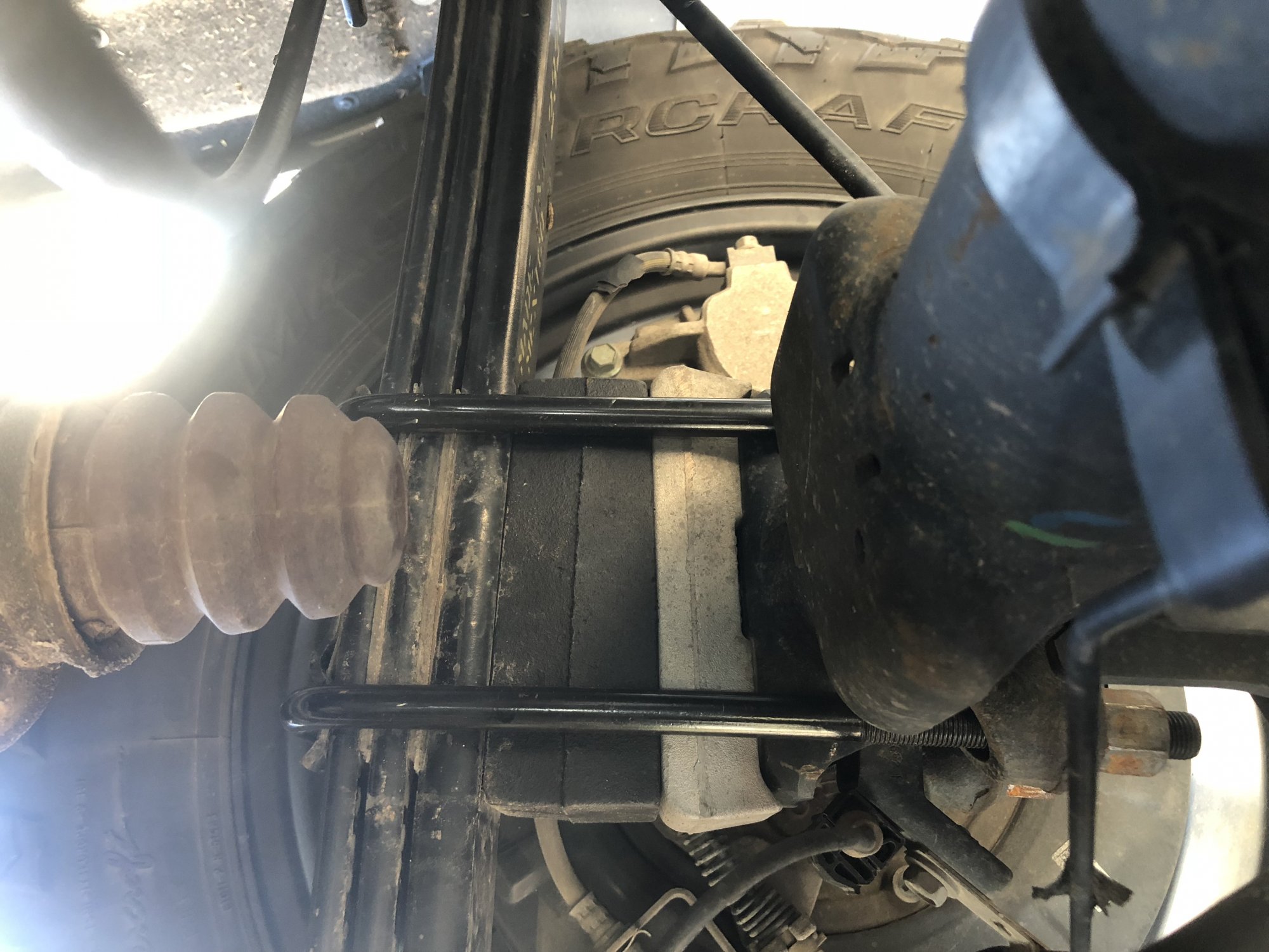

I just put a leveling kit on that had me stack rear blocks on top of my factory ones..WAIT!! I am not driving it until I get a solid block in there instead of stacking, I have a company truck to drive in the meantime..
My question is..The block I’d have to order to match my existing setup would be a 3.5”-3.25” tapered block. However, I have a vibration above 60mpg while accelerating. So, would I be okay with a 3.5” flat block? Seems pretty tall for a flat block, but I am getting a bad vibration..I’m used to Duramaxs and it’s always a rule of thumb to get a tapered block, these trucks are going against everything I’ve learned lol. Any help would be much appreciated so I can get this thing back on the road! Thanks!!
I know I'd never stack blocks on my rear axle.
If it was me I would try just the new tapered block and see how it is.
